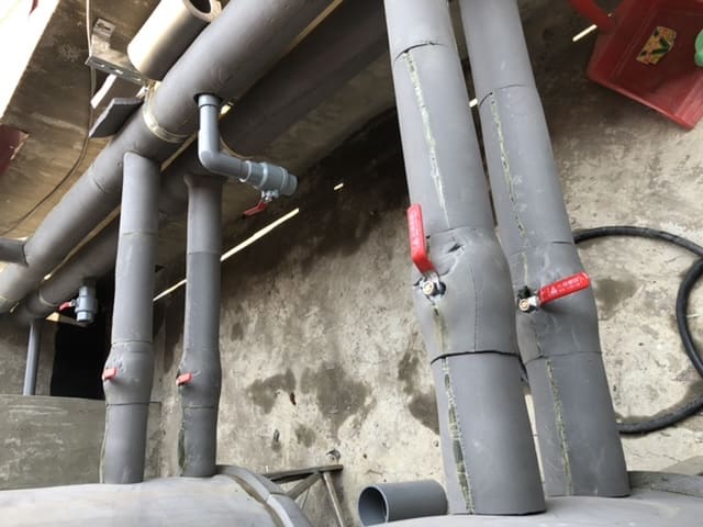

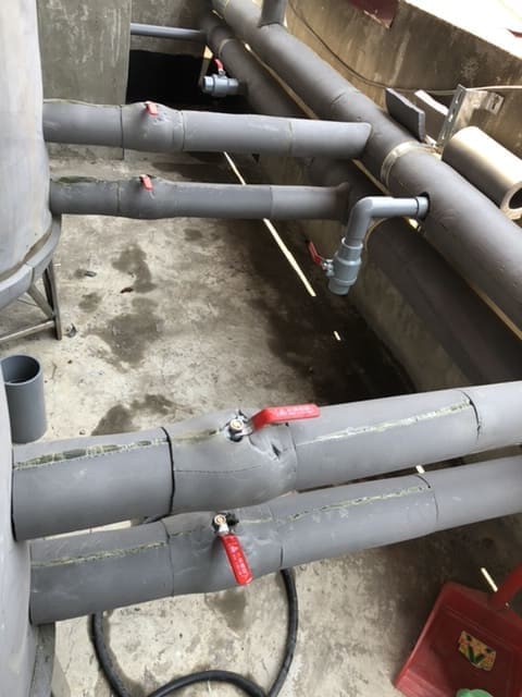

Image... the upper run of pipe with open valve goes to chiller pump 30ft or so below. I cracked open that valve you see elbowed down for the hell of it wishing it was at the upper most spot in line. Will have a valve installed if we have a repeat. The lower run of pipe goes to a chiller and returns to the right tank to give us coolest water. There are 3 and the left one receives the warm return water.
We won’t go into why there are 3 tanks and all the connections. Let’s just say it’s an improvement on what was there before. The suspicion is we developed the air problem 1 week after the changes you see.
The previous system was quite strange. 3 x 1000 litre tanks all open at bottom to the pump we are discussing 30 ft below. The 3 tanks were unconnected and had ball valves on return flow from chiller. We would end up with alternate tanks throughout the day taking charge of releasing water. The other 2 could be seen to have the ball valve closed and obviously not releasing.
The change was to connect the 3 tanks. They have pipes running between them you can’t see. They are now a single body of water and flow nicely. Added bonus was finding we can nicely control main warm return from cooling tower to chiller 1. Chiller 2 now sits with its own 3000 litre single tank in reserve. It’s set to kick in within .5 degree warming and circulates it body of water through the middle tank you see that’s off. It’s a nice setup because the middle tank circulates into both the warm return water and chilled outlet water. Provides a gradual steadying to desired temp.

Reading your description closely it seems like the photo is showing the tank outlet lines going vertically up. This is now a syphon system operating below atmospheric pressure. Any entrained air in the water will collect in that header until it breaks the syphon. Opening the small valve will make it worse.

"Reading your description closely it seems like the photo is showing the tank outlet lines going vertically up. "
I thought so too, but no, it looks like the photo is rotated ccw by 90 degrees. See the dustpan sitting on the ground in the right part of the pic? And the drape of the cable on the left side? Pipes are running horizontal, apparently into the bottoms of the tanks. Not clear if the second pipe (with adjacent valve in closed position) is the return (warm) water line, but it does look like the return is plumbed quite closely to the tank outlet (pump suction) line, which could entrain any air bubbles right back into the suction without letting them dissipate to the free surface of the tank.
Always handy to rotate the pictures 90deg, makes it more interesting.
Blueblood : a trap for young players, discharge the return line as close as possible to the inlet, it also helps if the discharge is allowed to free fall into the tank 😉
aaah, great spot, now becomes a bit clearer.
There is a mysterious pipe going up just at what is now the top of the picture.
The pipe noted is neither a drain or a vent. If there is no or a positive fall then air can still accumulate.
