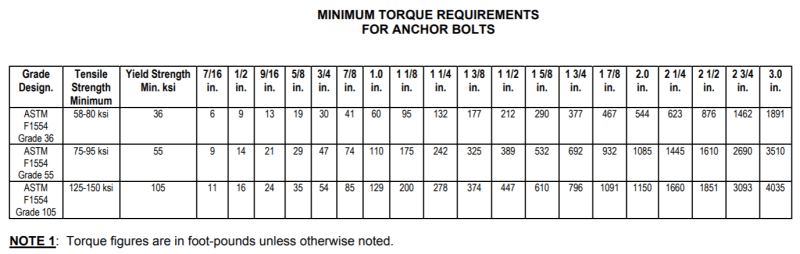

One thing to note is that torquing post-installed adhesive anchors is not the same as torquing a cast-in place bolt. Each adhesive manufacturer gives very specific torque requirements based on their resin. My understanding is that they are quite a bit lower than the torque you would be in for a cast-in place bolt. I believe that dik provided a table for CIP anchor bolts so that would not be applicable to your project.

The whole process of “torquing” anchor rods yields unpredictable results. As such, don’t pretension bolts unless it’s really needed.
I would look into whether or not it’s necessary for this application. I’m guessing it’s not.
