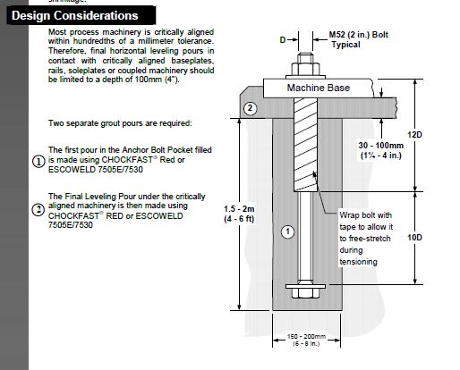

Seems like a bad idea from the standpoint of shortening the tensionable length of the anchor rod - from Chockfast anchor bolt literature
This is for building posts, not machines, so not concerned about the untensioned length. I heard someone else said they did this (well their firm did), and I want to know if it's a real solution. If it's reputable then I'd start using it but I don't see any references to this in AISC or anywhere.
