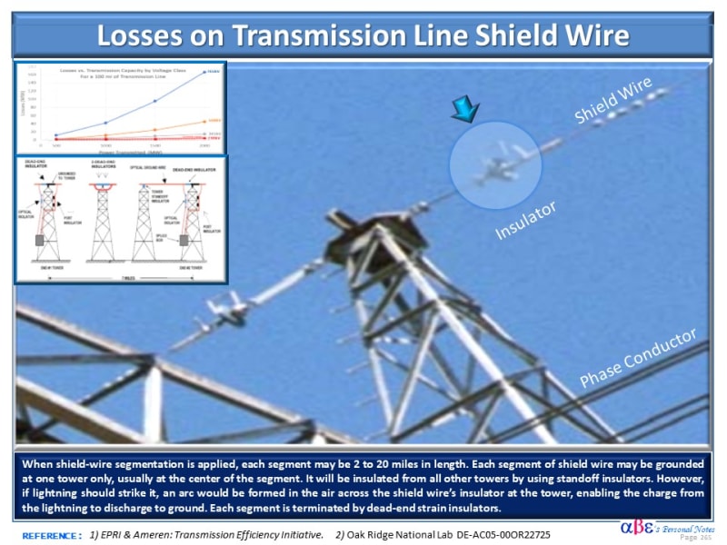

Cuky- How big are loss savings from isolating both ends? Isolating the first end saves all the inductions losses. Is the loss savings from isolating the second end mostly due reductions in corona losses, due to reductions in capacitive coupling current flow or due to some other factor?

Hi Bacon4life,
Unfortunately, there are many unknowns such as loading, configuration, length, and other data to provide a specific answer regarding losses on the shield wire for a 230 kV T. Line. However, in general terms, we can say that the losses in the shield wire for the 230kV (curve in red) are expected to be low considering the reference graph below.
I hope this information provides some inside into this issue.
