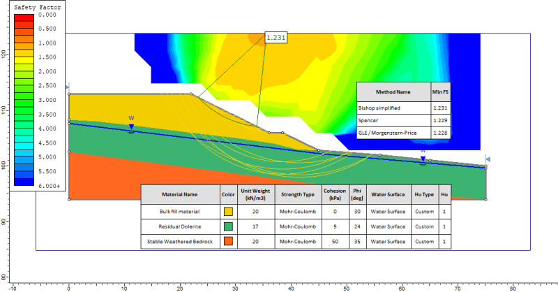

Hi All,
I have a site where the intention is to construct high fill embankments (50 - 70')on a hillside where there is no permanent water table. At a couple of locations on the hillside, broad, ephemeral drainage lines occur. My field testing has identified perched water tables through discrete soil horizons in the vicinity of these drainage lines and the soil profile is mostly residual dolerite clay-silt; soil class MH or A-7-5, with approximately equal proportions of clay-silt and effectively no sand or gravel.
One of the problems I'm confronted with is where to set the ground water table for my stability models. I'm looking for any reference that discusses this in detail. I have colleagues who insist that a water table will build up within my fill embankments at some point in their design life, but my feeling is that provided subsoil drains are incorporated into the valley areas, I should be able to analyze my new fill as a dry embankment.
Any help or advice would be greatly appreciated.

Mike,
I don't know of any references and I doubt you will find much in books or papers on the subject. It all comes down to local experience, how the embankment/fill is constructed, seasonal changes in groundwater conditions and precipitation, and probably many other less well understood factors.
I have worked way too many landslide projects where the cause of failure is increases in the predominant groundwater condition to not consider changes to the predominant groundwater condition. Here are some of the ways that I might deal with the conditions that you described.
1. Use a free draining fill material for all of the proposed fill. This essentially negates the placed fill from a groundwater perspective, so is a very safe option.
2. Install a fairly thick free draining fill layer between the natural soils and the proposed fill and daylight the drainage layer. Again, robust and if properly constructed, unlikely to cause a raise in groundwater levels in the natural soil. However, the fill may still saturate depending on precipitation, utility leaks, etc.
3. Model the slope (natural and fill) with elevated groundwater conditions and determine the likely FOS. If too low, flatten the slope or otherwise modify the design. Note that the target FOS should depend on how likely the conditions are to develop, this is not a one size fits all.
Good luck and let us know what you decide.

Mike,
Thanks so much for your quick and informative response. My bulk fills will be built up over a deep residual clay-silt profile (no significant transported soils, just a thin colluvial mantle), but for the bulk fill itself I will be using free-draining, rocky material in the lower layers at least.
Stability analyses show a relatively low f.o.s., around 1.3 when I assume a fully elevated water table in the natural profile, but no water table in the bulk fill itself. My intention was always to use rock blankets and a herringbone layout of subsoil drains across the valley bottom, but it now seems I will have to combine that with a basal geo-grid to get the desired f.o.s. (+-1.5).
It is very easy to implement the rock blanket and geo-grids over the valley bottom, so I'm happy to do so. But moving onto the sloping ground, it means having to cut an enormous basal bench on which to place the rock blanket and geo-grids, and this is the situation I'm trying to avoid. If I do opt for the conservative method suggested, which I agree with, it will lead to a significant flattening of the batters, from the current 1:2 (v:h) to 1:2.5 which means a lot of platform space is lost.
I suppose the correct option is to analyze as you've suggested, give the Client the option of either; large basal benches (cut to spoil and replace with rock grids and free draining fill material), or flatten the batters and lose some platform area.
I know that the developer and engineer will raise questions about my methodology, which is why I'm making sure I'm not being overly conservative. My founding material has a friction angle of about 24deg, and some cohesion, which I've moderated to 5kPa, so I know that 50 feet high earth embankments at 1:2 with sloping-away ground at the toe is ambitious.
Just wanted to run it past the seasoned veterans...the fill embankments in my region are just getting higher and higher as all the flat land has been developed, so I'm getting more and more of these situations.
My typical fill toe stabilization detail of late has been a basal rock grid, free-draining rock blanket of 500mm, separation fabric, and then bulk fill above. As I say, it's not prohibitive to place these over valley bottoms, but cutting huge benches for them on the slopes, and spoiling the large volumes of clay removed from those benches, creates serious drama with the Client when the volumes are put onto paper!!!

Hi Mike, from my understanding you are putting free draining fill on the side of a dry hill. This sounds similar to railroads and highway's in mountainous regions which I am not a specialist in but I am confident you can do some research on quite easily.
To assess the stability of the problem you first need to understand what is the stability of the existing condition. If this is a natural slope there is guidance to determine where the project area stands in relation to landslide susceptibility and if it on the brink of failure. You would then need to look at what parameters to adjust to make your project area to the brink of failure. Once you know that you can set your brink of failure to FOS 1 then work backwards to the existing condition.
In terms of pore pressures for your problem. You have mentioned that there are ephemeral drainage lines therefore you can model where the drainage line is as saturated and where they are not without. The questions then become, 1. how much time over a year is it saturated and how deep does the saturation penetrate? 2. What proportion of the slope is represented by which model and are there concentrated areas of drainage lines?

Thanks Guys for all the valued responses.
See below a sketch profile - we'll be taking the top off a natural hill, and filling out on the side-slopes. As noted by GeoEnvGuy, in general, we are putting fairly free-draining fill on the side of a dry hill. The free-draining fill material is derived from the weathered bedrock. The only groundwater seepage recorded is at depth at the toe of the slope, hence my belief that I could safely analyze my fill material as a "dry" bulk fill.
Note- I've already taken the precaution of GeoPaveTraffic and modelled the natural ground with an elevated water table. I attach also a screenshot of my stability analysis on Slide 7.
