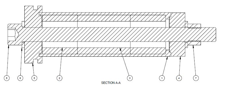

I am designing a fatigue resistant shear pin. The pin is essentially a tube with three plugs lightly pressed into the bore. The plugs control the shear planes (double shear).
The tube is 50 mm OD (g6), 44 mm ID (H7), 140 mm long. The material is 4140T.
Due to the interaction of the plugs there are high cyclical stresses both on the ID and OD.
To maximize fatigue life I had intended to grind or hone the ID to 0.2-0.3 Ra, and grind the OD to 0.2 - 0.4 Ra.
I would also like to shot peen both tie ID and OD. I am considering 0.006"A to 0.008"A intensity at 100% coverage to AMS2430.
I understand the shot peening must be the last operation and have located a workshop which can do this.
However I am wondering if the surface finish prior to shot peening is wasted money, given a shot peened surface is necessarily rough.
The workshop indicated a good surface prior to peening is still advantageous in order to avoid rolled burrs at a microscopic level, or significant machining marks the peening would not obscure.

The geometry is not clear to me from your description.
Nor is the surfaces of the cylinder and three pins where you are thinking about the shot peen. (ID of the tiny cylinder holding the pins?)
This may help clarify.

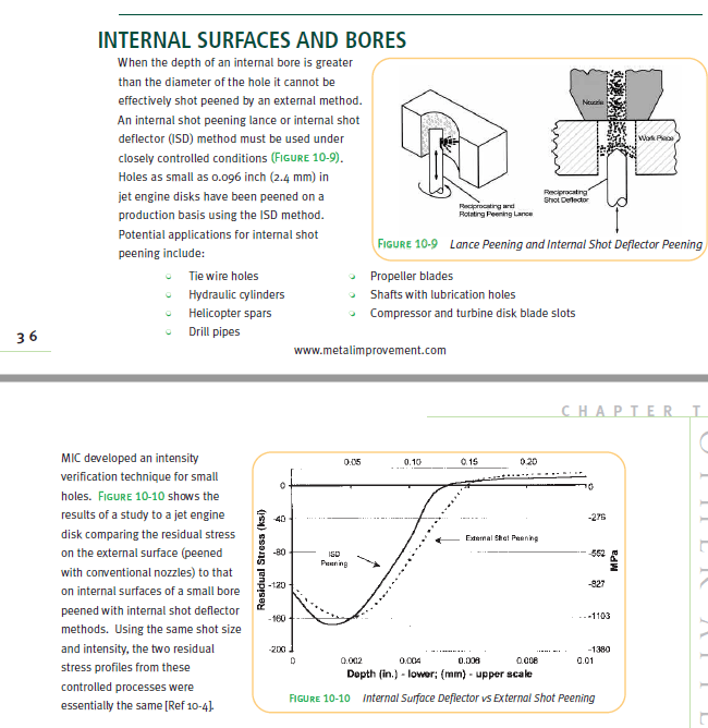

Since your L/ID is much greater than 1.0, you probably will not get a satisfactory result with conventional shot peening. The shot impingement angle on the ID surface will be very shallow. Shot impingement angle is very important, with 90 deg (perpendicular to the surface) being ideal.
You can use a shot peening technique like those shown below (lance or deflector) on your tube ID surface. The graph gives a comparison between external shot peening and internal shot peening using a deflector.
You might also take a look at roto or flap peening the ID surface.
Another possible option is roller burnishing the ID surface.
It is common practice to finish grind/hone a surface after shot peening. However, the amount of surface material that can be removed without affecting fatigue life is limited based on depth of the residual compressive layer. You can find more information in shot peening specs like AMS2432.

This Pin Assembly' has superficial resemblance to large shear pins used in aircraft shear-critical [wing-fuselage, stabilizer-to-center-section, pylon-to-wing, etc] joints...
However, the concept of internal 'stacked shear-plugs' is very 'unique' and appears to make the joint very complex. Hmmmmmmmm.

Regarding the design of the shear pin, I agree it is complicated for a shear pin design, however provides significant fatigue advantages.
It is based on an old patent which was developed by NASA. Link
