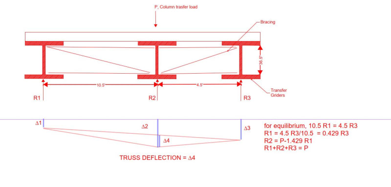

I'm designing a transfer girder which has a tight deflection criteria and the depth of girder is restricted by some ARCH constrains. I'm wandering into a idea of using 3 identical parallel girders( transfer column sits on middle girder)to distribute the column loads and use the stiffness of all three girders combined. I'm thinking of using tie bracing to distribute the load along three girders and engage the stiffness of all three girders. My question is that if my assumption is valid that the total downward load from transfer column will be resisted by the stiffness of all three girders combined as long my bracing is good in strength to transfer the load to the outer girders? If not, what stiffness is available for the deflection at the middle girder?

It could be a bit of work, but it is calculable. see below
Another way that may result in less total deflection would be to use 3 girders that are not identical. The moment of inertia of each girder is proportioned so that deflection, borrowing BA's terms, Δ1 = Δ2 + Δ4 = Δ3

BAretired Thank you for your response. I see some concern in your approach, If we solve this system of equation, it will always end in R1,R3= 0 and R2=P (I'm assuming your second equation was meant to be R2 = P-1.429R3) meaning no contribution from outer girders. I'm using slightly different approach, however the problem I'm running into is that in my middle girder is not contributing anything any the total load P will be just distributed to the outer girders. I think the actual behavior of the system will be somewhere in middle of your approach and my approach based on the stiffness ot bracing and girders, question is how can I capture that?

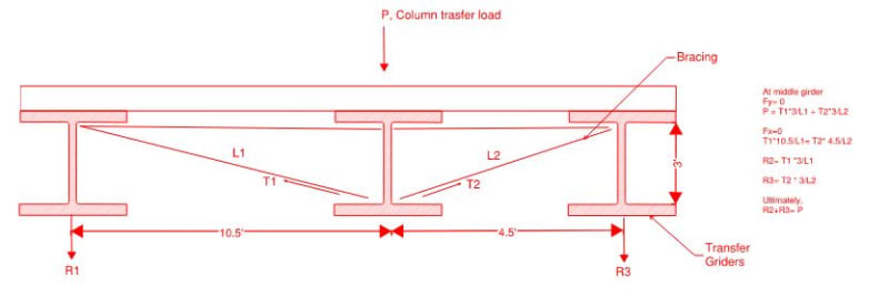

Realized, the calculation in the image above isn't clear. Here is a clearer snap. Also, R2 is R1 in the equations, typo.

Let us say that B2 is adequate to carry kP where k is a fraction less than one.
That means B1 and B3 must carry (1-k)P, so R1+R3 = (1-k)P.
But R1=0.429R3 so 1.429 R3=(1-k)P and R3 = (1-k)P/1.429
and R1 = 0.429(1-k)P/1.429 or 0.3(1-k)P.
Suppose k = 0.8 which means that B2 deflects more than it should if the load exceeds 0.8P.
In that case R1 = 0.06P, R2 = 0.8P and R3 = 0.14P, for a total of P.
That is true only if (a) the stiffness of B1 and B3 are consistent with the deflection corresponding to the calculated load and (b) the bracing truss does not deflect.
If B2 can accommodate only 0.4P without deflecting too much,
then R1 = 0.18P, R2 = 0.4P and R3 = 0.42P, for a total of P.
If B1 and B3 are too stiff, this will be conservative.
If the truss deflection is considered, B2 will carry more than 0.4P

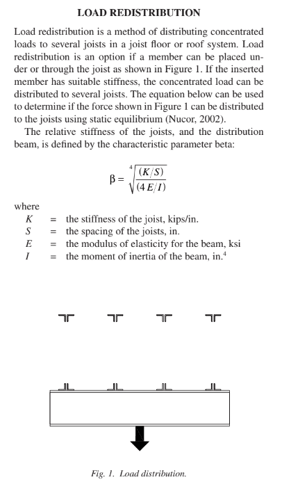

This feels like a common joist problem - I have a load to hang, but my joist isn't strong enough. How can I distribute the load to adjacent joists?
The result is based on the stiffness of the joists and the stiffness of the header. A very stiff header will distribute the load evenly to all the joists. A very soft header will not distribute any load to adjacent joists.
The stiffness of the joist is also based on where you`re applying the load over the length of the joist.
I suggest looking into that procedure for this application.
Once20036 Thanks for the suggestion, turns out we looked into similar thing. We ultimately designed bracing systems the a particular stiffness such that it transfers the load we want it to transfer.
This article may help: James M. Fisher's "Strengthening Open-Web Steel Joists"
