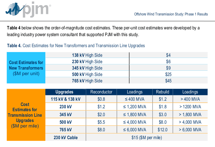

A recient PJM study provides some current pricing relevant to your question.
