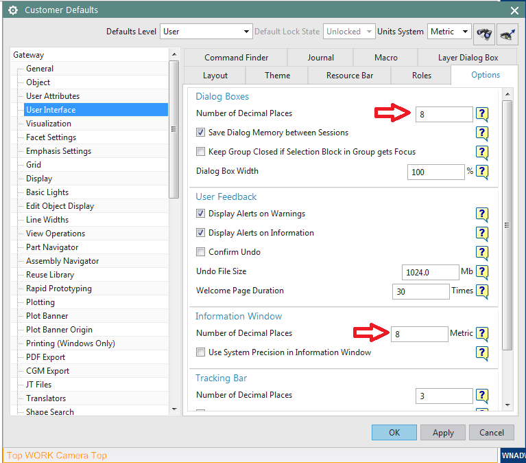

Is it possible to set the number of decimal places displayed in the "Geometric Properties" dialog box?
It is a very handy tool, but would like to increase its precision.

The decimal places in your information window can be changed in your Customer Defaults. There are two places for the different units.
File (pull-down) > Utilities > Customer Defaults > Gateway
Jerry J.
UGV5-NX11
The picture is actually wrong, I am not showing the two places (units) to change them, but you can see where to change for millimeters and you can probably find the inches from there.

Jerry, thanks for attempting to answer this.
I have set the dialog box decimal places to 6, Info window to 12, and tracking bar to 4. Unfortunately the geometric properties dialog results still appear as 3 place decimals.
So the search continues.
If you changed your Customer Defaults, it won't take effect until you restart NX and create a new file.
Before you restart, try changing the settings under Preferences -> User Interface -> Options (on the left) and make sure the dialog is fully expanded and you should find entries for all 3 items. If Use System Precision is checked/ticked, un-check it and enter 12 if that's how many decimal places you feel is required.

I have a feeling that the geometric properties dialog box is hard coded for 3 decimal places and won't be affected by any of the above options. I don't think you can adjust the number of decimal places for this particular dialog.
I suggest contacting GTAC and opening an incident report (IR), if what you want is possible, they will tell you how to change it; if it is not, your IR will be turned into an enhancement request (ER) for possible inclusion into a future version of NX.

Before I changed it to eight, as shown in the pic, it was 3 places, and worked correctly after I changed it and rebooted, the next day.

For the record, I'm talking about the "results" section of the geometric properties dialog box when you do a "dynamic" analysis and drag the cursor over a face; the results here seem to be fixed at 3 decimal places. Perhaps I misunderstood the question; if so, sorry to add to the confusion.
www.nxjournaling.com
cowski, you are understanding correctly. The "results" display using the dynamic geometric properties.
Sorry for the confusion. It is nice to have the immediate feed back of the dynamic.
