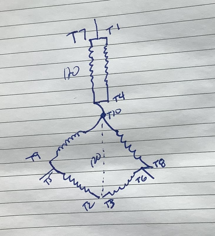

I’ve worked on many of the old military 10 and 12 lead generators converting them to single phase.
I can draw out what I think I want the connections to do and the math seems to work. I’ve just never really had the nerve to try it with a generator that’s working fine...
Please, go into this bar diamond/ Collins connection a little farther.

Collins, 120:208 Volts to 120:240 Volts only.
You have a permanent star point with leads 7, 8, 9 and 10.
Leads #1 and #4 connect to leads #7 and #10 respectively.
Leads #2 and #5 connect to leads #8 and #10.
Now you see a zig-zag,
Leads #3 and #6 connect to leads #9 and #10.
Now you see a zig-zag that is a mirror image of the first zig-zag.
Naming.
If you draw a vector sketch with the #1-#4 and the #7-#10 windings horizontal and on the left, the #1-#4 and the #7-#10 windings form a horizontal bar.
The right hand side of the sketch forms a diamond.
Hence Bar-Diamond.

That like what I had envisioned.
Thanks for the reassurance.
I know where a 120/208 400hz unit is coming off and being replaced with a 60 hz unit.
I’ve called to ask about the timeline. I’m going to reconfigure it this weekend and check it out.
I see quite a few 10 wire on the old military generators.
Now the Collins on the other hand...
Still working..
Edit..
I have T1&T4 paralleled with T7&T10
T2 connected to T3, T5 connected to T9, T6 connected to T8.
Bar diamond? Looks right on paper anyway.
It didn’t read quite right in your post..
That looks right for the Collins connection.
Before making the T2-T3 connection, do a voltage check.
You should have:
T2 to T3> zero volts.
T10 to T2> 120 Volts.
T10 to T3> 120 Volts.
