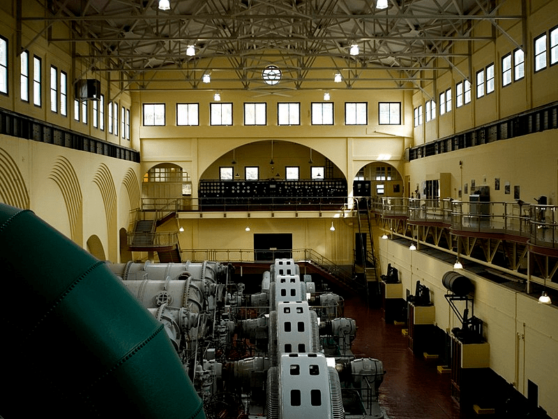

95 Years ago this power house was British Columbia's largest source of hydro-electric power.
The old Stave Falls Power House
In the 70's this power house was under manual control.
The generators ran at either 10% output to keep the sets warm and turning or at 90% output when the power was needed.
I lived about 2 miles away at the time and dropped in one day.
The one operator on duty was happy to have a visitor and give me a tour of the station.
The plant was running at 10% output.
While I was there, the phone rang.
It was central dispatch requesting 90% output.
The operator started to advance the set-point of a droop governor to pick up load.
The operator would stop from time to time and manually adjust the field current to bring the PF up.
He did this about three times before he reached 90% output.
Then he repeated the process for the other four generators.
When the afternoon peak was past, the phone would ring and the sets would go back down to 10%.

The Stave Falls Power House as it looked when I toured it.

Thanks for that, Bill. Presumably "central dispatch" had some means of determining the river flow throughout the year, and would adjust the number of units in service so as to pass the amount of water available while avoiding both inefficient operation and spill...
The turbines look very much like horizontal Francis units; the design of these is such that they can tolerate extended periods of operation @ 10% gate [ or was it 10% of rated output? ] without sustaining damage due to cavitation.
Operating generators in stations and cows in barns in the winter can both have the same effect: keep the structure and the earth surrounding it from freezing temperatures, dramatically extending its life.
