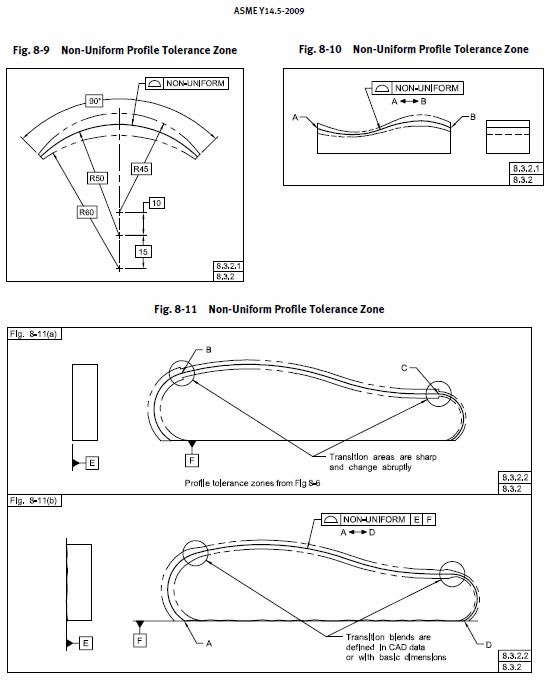

I want to dimension a v block that will hold a 35mm OD tube in place. The height of the tube is most important. I have seen tapers dimensioned like this, but can this be applied to a v profile or is there a better way of dimensioning this?

Make 22.5 (0.886) basic. The rest is good in my opinion.
If you want to make it super-clear a profile between points would be also acceptable.
Point A (beginning of the "V" shape) , Point B (ending of the "V" shape)
Profile between A and B.
Thanks greenimi! So I don't care about the radius dim as much as the sides of the v holding the tube at a particular height (there will be 3 of these v's in series). Is there a way to keep the sides tight and loosen the tolerance on the radius? I feel the profile tolerance on the v would be too strict on the radius when not needed.
A non-uniform tolerance zone would do it.

Than maybe another profile between points is needed for the radius alone with bigger tolerance value in the feature control frame.
Left and right "V" shape - profile with smaller tolerance value--one profile control with two leader lines maybe
"V" shape apex -profile with bigger tolerance value (as a stand-alone feature control frame callout)
Again, if you want to be super-clear a profile between points could be used......not sure really needed in this case.
If you really want the height of the contact with a 35 mm tube closely controlled then I would dimension it like that. Put a 35mm basic ball gage diameter in the V and dimension from the datum A to the top of the ball. People get all carried away with profile because the standards makers think it's so wonderful but dimensioning for function is much better in many cases. Just like here, nobody cares what the radius is and you really don't care all that much about most of the vee, only the tangent points to the diameter.
"Non-uniform" option for me looks like an "overkill" and if the OP is not using 2009/ 2018 then probably is not available for him.
I don't want to get (again) into a lengthy disagreement, but the option with the ball gage is more an inspection method driven approach.
And since each and every inspection method has its uncertainties (are just some form of estimation of the actuals) the gage ball method is no exception.

I would say no more overkill than separate profile tolerances. Assuming OP uses Y14.5-2009 or later. If one wants to really simplify it just put 2X profile and 2X leader lines to the pair of inclined faces and make the radius directly toleranced instead of basic. *Edit - I see OP is only on 1994, indeed then non-uniform is not an option directly supported by the 1994 standard. A note could be used, but in that case I would agree is overkill. Separate profile tolerances or the aforementioned directly toleranced radius are the best options.
