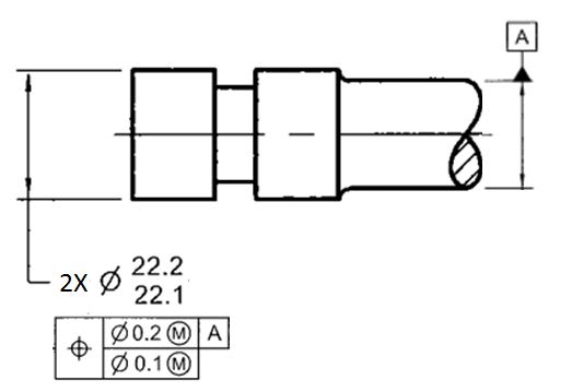

I am not sure if this will help, but technically there are also scenarios where only one datum in the upper segment of the composite FCF would suffice.
Pmarc,
Maybe similar configuration to fig 4.5-2009 page 51 if position callout for the 6.6mm holes is changed to composite? Are you talking about this scenario?
Only primary "A" will suffice. Correct?
greenimi,
I was thinking about something like this (sorry for crude sketch).
But this definitely isn't the only possible example. Below is another one:

That being said, I initially avoided mentioning it but since the cat is out of the bag... I can't see a situation where zero* datums in the PLTZF would be allowable or beneficial, as the lower segments would not provide any further refinement, unless maybe the "INDIVIDUALLY" notation (or other similar method) was used - can you?
*Edit: I should have said "datumless PLTZF" - I'll blame in on my friday brain
chez311,
I understand. My impression, based on OP's initial post, was that for her/him composite FCFs with two datum references was something unusual. To show it was not, I mentioned composite FCFs with a single datum reference.
To your question, I too can't see a situation where a composite FCF with no datum references in the PLTZF would be allowable or beneficial.
What if it was in conjunction with another feature with a profile tolerance that also had no datum reference for a simultaneous condition, perhaps with the "all over" modifier?
Could you create an illustration for that?
Float a couple of holes into '2009, Figure 8-8. No datum references required.
3DDave, when adding two holes to Fig. 8-8, of course no datum references would be needed for a regular, single position callout -- there are simultaneous requirements at work. But the question was about a composite position callout having no datum references in the PLTZF. Not sure how your example would make sense with that idea.
Because the holes could float farther than with respect to each other.
Seems like a 100% perfect description of how sand castings work with mold inserts. I presume that was the reason for the "all over" modifier.
I see it now and agree it could work.
Few comments to the example with all-over profile, though (mostly for clarity):
- I think to make it work the profile FCF would have to be applied at "unless otherwise specified" basis, otherwise someone might have taken it as applicable to the holes too;
- I think that addition of 'SIM REQT' to the upper segment of the composite position and to the all-over profile would be recommended (required?), otherwise someone might have said that the concept of simultaneity between separate datumless FCFs does not apply (this was discussed in the forum many times before).
3DDave,
I think I see what you're getting at. The upper control frame would hold the pattern fixed in relation to the datumless all over profile with SIM REQT, whereas the lower frames would allow tranlsation/rotation to this all over profile. Interesting! As always, thanks!
pmarc,
Thats a good point about showing an example of a single datum reference - I'm glad you brought it up, and I think it added an additional dimension to the concept. I also agree about explicitly adding "SIM REQT" to a datumless FCF to eliminate any question of whether simultaneous requirements applies.
