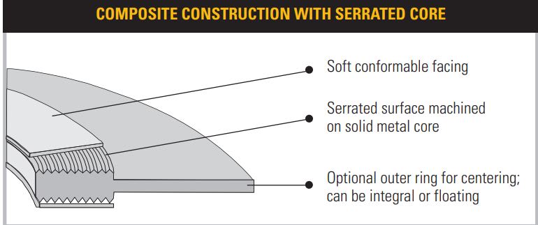

Does Kammprofile gaskst against the galvanica corrosion better than sprial wound gasket as the facing material is insulation materials?

Thansks for sharing. it's very usefully information from reaserch and study.
In order to stop galvanic corrosion happening between CS and SS flanges, Flange Isolation Kit is used. This kit looks like following. This kit is also used providing Isolation to Cathodic Protection between an underground section to Above Ground section.
