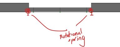

The reason I'm asking is because assuming that the beam is fully continuous at the splice points, for seismic analysis analysis purposes is unconservative
I'm thinking maybe I can do some FEA to try to come up with a rotational stiffness at the connection points. Then, I can model this in RISA with a rotational spring, like the one in the attachment.
