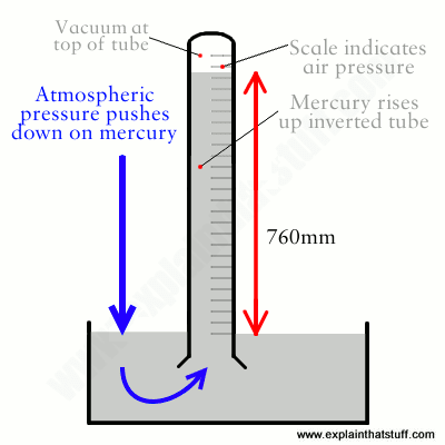

Basically your tank acts like a barometer.
Since you have water in the tank, it needs the 33ft level.
If you have Mercury, it's only 29.92 inches tall.

I think that is true. If you filled the tank without purging all the air and then closed all valves, the tank is a pressurised tank (in terms of absolute pressure), air pressure = 1 atm. At lower points its + rho g h.
That is why water exits the tank, if all air is not purged out. The same way the barometer works. You must allow for the surface level in the cup to vary as the atmospheric pressure changes and affects the volume in the tube. Mercury enters and leaves the tube and its height changes corresponding to the momentary atm pressures. A barometer with air trapped at the top is not very accurate at all. I had to turn the tube upside down and fill it with Mercury, put my thumb on it and invert the tube, placing it (and my thumb) into the cup of Mercury. Then it would read correctly.
If there is no air inside, then no (little) water exits, as the pressure almost immediately becomes vapor pressure when the outlet is opened. It is not exactly immediately, as there are vaporisation rates that should be considered, if you want to look at the milisecond scale. Stoner Pipeline Simulator Operating Manual explains all of that in conjunction with predicting vapor formation and collapse rate when fluid in a pipeline oscillates around vapor pressure. Availability of Heat of vaporisation and condensation must be incorporated (with a fudge factor) to get the simulation tuned to match observed fluid column collapse pressure waves. The simulator isn't very accurate without that tuning, but does tend to give higher pressures and faster times without the tuning.

Assume the pressure inside and outside the valve are equal, there is no visible flow of air in or water out, then solve for h. Look at the barometer problem where the "hole diameter is infinite". Solving for h, you will see the water should be at 10m. If you do see only a 5m height, something is wrong; the valve is closed, or maybe it is because there is air trapped inside. Now calculate the amount of trapped air inside the tank, assuming a tank area of 10m2
Pressure inside the tank at the water surface is
1 Bara, atm pressure outside the tank
-5m water inside the tank = 0.5 Bara
= 0.5 Bara at the water surface
Empty space inside the tank
(11m-5m) x 10m2 = 60m3
Pressure = 0.5 Bara
