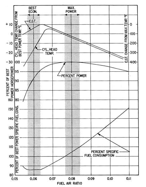

At higher revs and high load, that's when you get into enrichment, and higher FMEP, and so forth. At light load, that's where it's in a bad part of the BSFC map, and probably torque converter unlocked and slipping. I doubt if it's all that sensitive as long as you are somewhere in the middle third of the rev range.
If you're one of the rare folks nowadays with a row-your-own, maybe half throttle, but keep the revs in the lower half. Half accelerator-pedal position at lower revs translates to much more than half of rated torque, and that's what you want for best BSFC, but you want to stay out of floored-throttle enrichment.

At WOT the engine operates in closed loop mode so the O2 sensor is ignored.
Given that the O2 sensor is the fueling feedback signal, it's not very likely the engine could be both in closed loop and ignore the O2 sensor.
Newer cars with wide band O2 sensors will stay in closed loop at WOT but older cars would go into open loop (not sure when that change was made). New and old cars alike are both open loop for the first couple minutes after starting to get everything warmed up.
Open loop, not closed "At WOT the engine operates in closed loop mode so the O2 sensor is ignored. " And i think they tend to do this a or near full power rather than WOT in general.
Cheers
Greg Locock
I would take the x-axis values as indicative. Highly boosted engines, when aggressively tuned for max power, may benefit from enrichment all the way up to 0.10 fuel air ratio.
Correct, some newer cars are using wideband O2 sensors and staying closed loop most of the time. When in closed loop at WOT the O2 sensor still isn't being ignored, as I posted.
Heck, newer cars with narrowband O2 sensors stay in closed loop most of the time.
