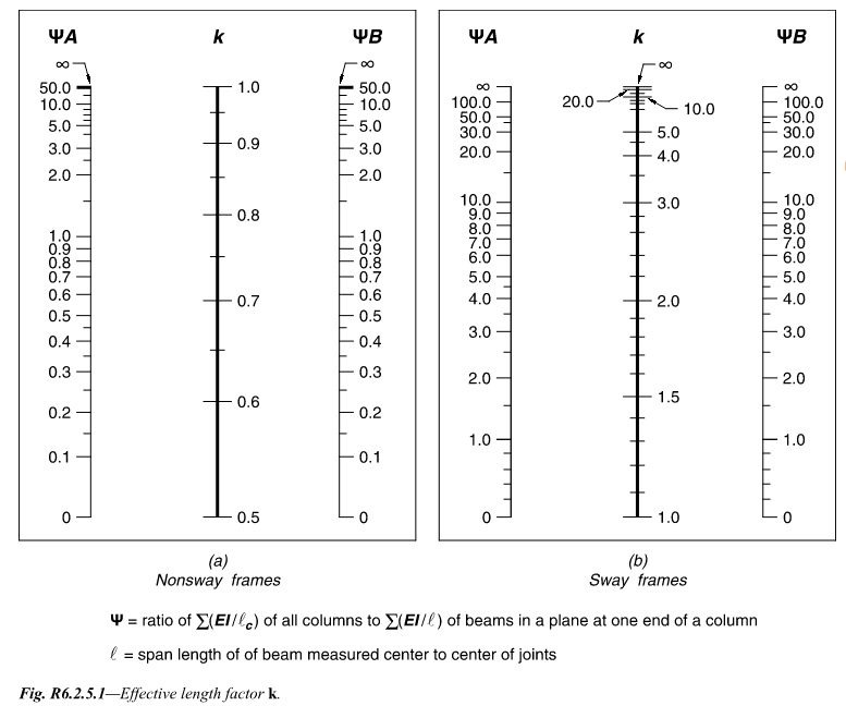

The slenderness stuff in NZS3101 is based on braced columns I believe, ACI has effective length values for unbraced columns if you have access to that.
For example these are the alignment charts from ACI:-
Eurocode EN-1992-1-2 with Amendment 1 (released later 2019) has tables in Annex C for sway columns.
thanks for replies
- Agent666 these seem to give the same k values as AS3600
- RAPT perfect! i will now get a copy of A1, i was using a pre-A1 version of EC2
