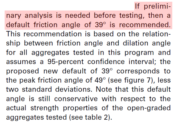

There's a thread I couldn't respond to on this subject - where the general opinion was 40 degrees was as high as you should go. FHWA did some large scale direct shear testing and got more than 50 degrees - FHWA Publication No.: FHWA-HRT-13-068

Per the FHWA Publication in the link, seems the answer is "No":
The graphs and figures in the publication may cause confusion since they show the "Peak Friction Angle" which is in the 49o+ range. The "fine-print" in the recommendations clarifies this by explaining the peak friction angle is at the top of a statistical distribution and "two standard deviations" above the suggested 39o friction angle.

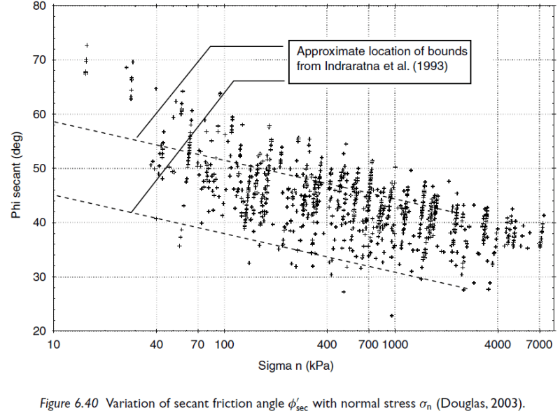

It falls off with increased confining stress. I think even 50+ is possible at low confining stress, but the envelope is highly non linear and you wouldn't want to do a model or calculation using a linear mohr-coloumb failure envelope based on a friction angle measured near the start of the graph

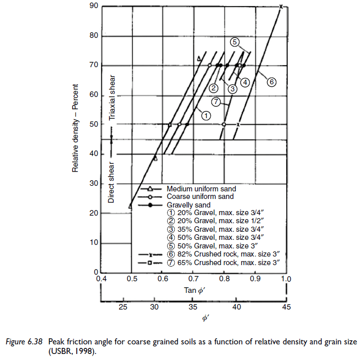

Depends mostly on compaction and effective stress, in dam design you sometimes see a strength envelope for the rockfill which decreases with an increase in effective stress for very tall dams, or they just use 37 to 42 degrees which doesn't usually drive the results as the problem is with the foundation materials. Included below are snippets of the effect of shear strength vs relative density and shear strength vs confining stress as well as a table which has the references of the researchers looking at the different factors.
Some newer research, with an even higher max for some material types
Note that these are all from large-scale triaxial testing not angle of repose - it would be interesting to compare the two. But I would be very hesitant about relying on angle of repose for anything, however appealing of an argument it might be on a construction site
