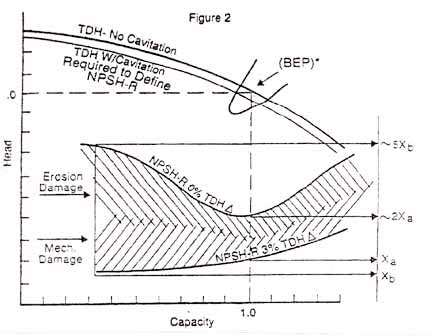

Also NPSH limit is NOT the same as cavitation limit.
Usually the cavitation point is anywhere from 1 to 5m ABOVE the NPSH curve.
You need to ask the vendor to give you the cavitation curve.
Typically like this
At cavitation initiation it is very difficult to hear it without very good microphones and you need to start from a high inlet pressure and then slowly reduce in order to identify the high frequency sounds of collapsing bubbles.
but having no answer about the materials is pretty damming so you might have a get out of jail card right there.

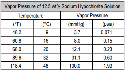

Thanks a lot for of your feedback. We verified with the sodium hypochlorite system licenser and he confirmed that the concentration is of sodium hypochlorite 0.2 % and the vapor pressure is 1.7 kpa.a which is very low. The suction tank is continuously vented by blower.
Youssef,
It's not the vapour pressure per se that we're talking about. It's whether when mixed with your seawater does it create micro bubble of gas due to the chemical reaction. This has caused bubbles and vapour locks in other similar systems.
It will be a transistory thing as the chemical reaction takes place so taking samples and testing them won't be simple.
