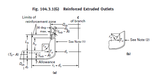

My Tee's coming under reinforced extruded outlets means any externally welded any Reinforcment pad should be there? And the Size of the run to branch there is no restriction right? for example DIA 1600 mm X DIA 600 mm TEE can also be reinforced extruded outlet?
Can you pls explain below point?
(G.2) Definition. An extruded outlet header is
defined as a header in which the extruded lip at the
outlet has an altitude above the surface of the run that
is equal to or greater than the radius of curvature of the
external contoured portion of the outlet; i.e., ho ≥ ro. See
nomenclature and Fig. 104.3.1(G).

If your calcs indicate that you need re-inforcement then yes you will need to add some re-inforcement, but if not then you don't.
There is no restriction on size, but in practice much more than 60-70% branch to header size is difficult to manufacture.
Do you have a copy of B 31.1??
What it means is that as per the picture below, the lip of the branch is higher than the radius of the outer bend.
Looking at your picture, it doesn't comply with this requirement as far as I can see,,i.e. the radius is bigger than the height h.
If doesn't look like a well produced extruded tee to me.
The type of tee installed must match (or be better than) the SIF used in the piping stress analysis. For example you can not change from a weldolet to the a reinforcing pad tee, the SIF is quite different. Changes must be checked in the stress analysis.
The designer may have added extra reinforcing to lower bending stress even if this is not required for pressure.
