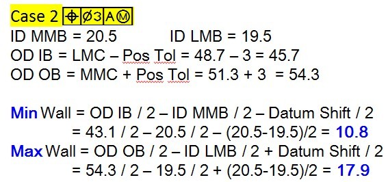

Calculate the minimum wall thickness
When both features (considered features and datum feature) are at RFS, do we need to include both form errors in the stackup calculation?
Cylindrical part with a thru hole
Dimensions in mm
ID: 20 ± 0.5—datum feature A
OD: 50 ±1.3, position Ø3 (RFS) to A (RFS)
What is the minimum wall thickness:
Form error on A: 2x 0.5 = 1mm
Form error on OD: 2x 1.3 = 2.6mm

I think the mistake is not on the form error, since we didn't consider the datum shift, here is my new calculation on the 2nd case.
Season
New calculation.
Season
Well, I think I am still wrong again. Tired
Season

You said you knew how to get to 10.8 for min wall thickness (with A referenced at LMB), so in the attachment I am just showing how to get to 18.4 for max wall thickness. Again, the key thing is to realize that the size of datum feature A's LMB is not 20.5, but 21.5. The rest is nothing but a trivial arithmetic.
pmarc,
I am trying to get the concept of LMC.
Yes, I got 10.8 as a min wall thickness (with A referenced at LMB), but probably just because of stroke of luck not because I fully understand the concept. (my monthly moment of honesty:):) )
How I got x min (minimumm wal thickness when A is LMB) is the following:
+48.7 (OD at LMC)
-20.5 (ID at LMC)
- 3 (poisitional tolerance)
- 0 (no bonus for the considered feature, in this case OD at RFS)
- 1 (datum shift , datum feature is at LMC, 20.5 shown before, but the callout in position is at MMB, therefore shift is available)
-2.6 (form error on the considered feature, since the OD is at LMC, shown above 48.7)
Total: 21.6
21.6/2 = 10.8
I am trying now, to make the same sketch concept for x min similar with the one you showed for X max. Not sure I am able to, but at least I am trying....

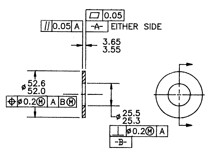

Alex covers form controls on Chapter 14 of his Tolerance Stack workbook though no examples similar to this thread using position tolerance, I found something similar but instead of form tolerances he uses datum shift tolerances. Would it be consider the same?
Threads like this spike more my interest. I always thought that datum shifts or form controls can only apply when the M/L modifier is called after the feature control tolerance (per washer drawing; Modifier after 0.2 Tol), just like bonus tolerance. But i see not necessarily, even if is called after the datum features such as Case 2-3. I find that this is the opposite of finding the gaps limits where usually datum shifts or form error are not involved.

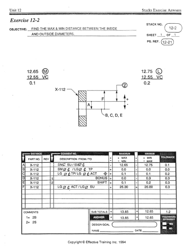

As a challenge, I would ask anyone to calculate the X max. and x min. for Exercise 12-2 (your embedded pictures) when the position and the datum feature are RFS/RMB
Maybe the form error will be considered or maybe not since datum feature B is secondary and the related actual mating envelope (not the unrelated one) will have to be used.
Position Ø0.2 (RFS) to A primary and B (RFS) secondary.
Perpendicularity stays the same.
