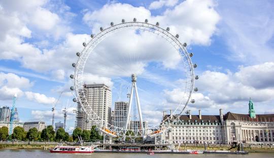

(The London Eye is another tension structure. But it is probably more obviously so and has a less uneven load distribution.
