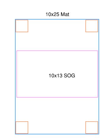

I have a mat foundation which sits ~2'-3' below grade supporting columns.
We have a SOG supporting equipment loads at grade above the mat footing.
What would be the best way to determine the effects (if any) of the SOG loading on the mat foundation?

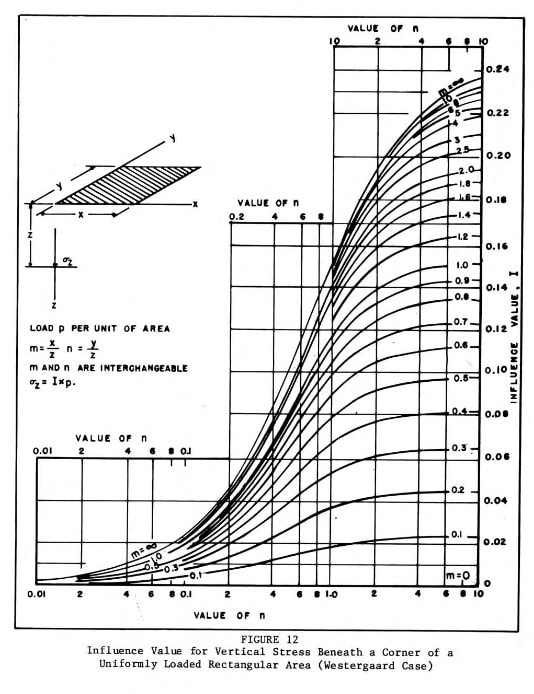

If I assume say 12" of compacted fill underneath the SOG and then 2' from there to the top of the mat slab, would using Fadum's chart to calculate the reduced demand on the mat slab be a reasonable approach?
I would assume the DL and LL on the slab acts 2' above the top of the mat slab and use the chart accordingly.

My elevation view wasn't clear so I've attached a plan view also.
The pressure should be able to spread out and dissipate around the sides beneath the SOG.
Would you still consider that a confined condition resulting in 100% load transfer from the SOG to the mat?
This is different than I pictured. Why are you using a mat at all? Can you use a footing for each column and a separate slab?

If we do go with the mat, would the Fadum chart approach to determine a reduced loading be reasonable?
jreit - I'm not familiar with that chart, but the concept looks reasonable. As some others have stated though, I doubt the reduction in vertical stress from the spreading of the slab on grade load will have much effect on the structural design of the mat. This load should transfer straight through to the bearing soil below.

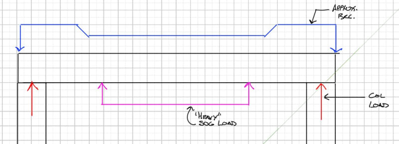

Because the 400 psf load plus the weight of the mat are transferred directly to the subgrade. If you didn't have a mat, the grade slab would bear directly on the soil. The columns are putting tension on top of the mat, hence its weight and the 400 psf soil load are reducing the stress in the mat.

Flip the system upside down:
The "heavy" slab on grade load gives a similar effect to post-tension balanced loading
Ultimately the "benefit" of the SOG loading depends on the relative magnitude between that loading and the column reactions.
Turning it upside down is a good way to understand the statics of the situation, but remember that, even if the "SOG Load" is more than required to benefit bending in the mat, mat deflection is limited by the presence of the subsoil. If you insist on having a mat, its behavior should be treated as a mat on an elastic foundation. Unless there exists some convincing reason for using it, the mat should be omitted in favor of four separate footings.
