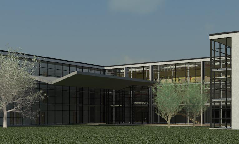

Ah yes, I am very familiar with the architect's choice of materials here.......the ever popular leve-tanium. Very strong, very lightweight, and invisible to the naked eye. Often found in very long spans with little space allotted for framing.
MotorCity - Yes! - that is how this cantilever got constructed I think:

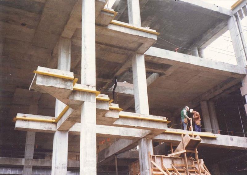

I had fun doing this series of cantilevers several years ago. But they all worked in terms of strength and stiffness.
