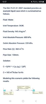

Goodday. Does a valve reduce volumetric flowrate. l ask because we use valves to reduce flowrate, but according to valve software, only pressure drop will be realized, but flowrate will not be affected. See attachment. Thanks

So the valve data sheet shows at a flowrate of 360 m^3/hr there is a pressure drop of 460 kPa across the valve. The equations at the bottom of the data sheet give the Cv flow coefficient of the valve which allows you to calculate the pressure drop across the valve for any flowrate. So if you want to design your system for a given flowrate say 360 m^3/hr shown, you will then have to deduct 460 kPa across the valve from the total available system differential pressure. It is not that the flowrate is not affected, but it is assumed a given flowrate and then the pressure drop across the valve is determined. However the flowrate that you assume (design the system for) can only be obtained if the sum of all pressure drops across all piping components (including the 460 kPa loss across the valve) equals your available differential pressure. After you subtract all the losses for valves and other piping components at a given flowrate, the sum of pressure piping pressure drops must be equal to the actual available differential pressure to get the assumed flowrate. The valve data sheet below just gives you the pressure drop across one piping component at a given flowrate. You must add this one pressure drop to all pressure drops in the piping system to get the total pressure drop.
If the flowrate you chose/design for gets you a lower pressure drop in all the piping components then the actual flowrate will be higher until the sum of pressure drops across piping components equals the available differential pressure, if you really want to maintain a flow with a lower pressure drop then available then you would install a manual valve, control valve, or restriction orifice to artificially induce more pressure loss to get the exact flow you need. If the flowrate you chose gets a higher sum of pressure drops across components then the actual flowrate will be lower than what your assumption was. If you really need higher flowrate then you will need to upsize your pipe to reduce the pressure loss. This is how you determine the flowrate in a pipe for a given set of components and pressure drop - sum of pressure drops equals available differential pressure is where the flowrate will be in equilibrium.
