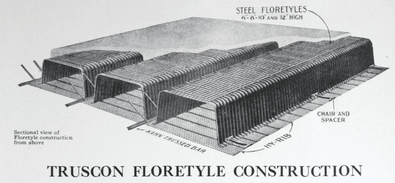

Hello all,
anyone know of a smart way to reinforce Floretyle concrete system? The architect wants to add weight...
Thanks!
My first thought is carbon fiber, similar to whatis done for parking garage precast tees. You could also look at reducing spans or adding steel or concrete beams between the joist stems.
