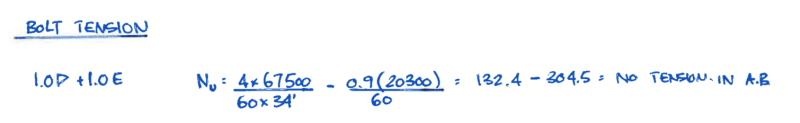

Good morning Eng tippers,
For flat bottom vessels, is it safe to rely on the operating dead weight to counteract seismic overturning moments, when looking at anchor bolt tension?
I am concerned that the flexibility of the bottom plate will prevent the content dead weight from counteracting bolt tension.
PIP STE03350 has this equation for calculating anchor bolt tension, however I am unsure if it is equally applicable to flat bottom tanks as it is to skirted tanks.
Thank you.

The overturning moment is 65700 ft-kips, operating weight is 20300 kips, bolt circle is 34 ft, 60 anchor bolts.
Using the PIP equation for bolt tension, you would get:
Would it be applicable to use the equation as above? Or should I remove the dead load portion and design for 132 kips tension in the bolts?

We actually have a skirted tank, so there is no tension in the anchor bolts as per my calculation above.
My question is purely academic, if this tank were not skirted and had a flat bottom, than the anchorage would have to be designed for the full overturning moment without reduction from the product weight.

In the case of a flat bottomed tank with your geometry, since the shell flares out at some elevation the product weight outside the 34' lower diameter would be supported by the lower shell, and would reduce the anchor bolt load. However the product inside the 34' diameter would load the bottom directly and not reduce the anchor bolt load. This would be more of an API 620 design, but certainly not an API 650 one.
Your geometry sounds like a high-density tank at a pulp mill, but it's probably something else.
Thanks Geoff, that is helpful.
Basically, for a flat bottom tank (with shell flaring out) you still load up the shell from the product weight on the upper portion - This is interesting, I hadn't though of this.
For a standard flat bottom tank (with no flare), you ignore the product weight for bolt tension - which, in my opinion should be clarified in the PIP guide.
And finally, for a skirted tank, the product load will reduce the bolt tension, and in my case reduces the bolt tension to 0.
Good guess - you are right, its an HD tank in a pulp mill.
I reserve the term "flat bottom tank" for simple cylindrical vessels. I find it too confusing to call an HD tank an FBT.
Once you get away from a simple cylindrical shape you need to think through the load paths from first principles, not just grab a formula from some place.
Good luck getting PIP to change. However it's not obvious to me that they intended the guide to apply to an API 650 FBT. Since API fully addresses anchorage design they might not imagine anyone consulting their PIP for this.
HD tanks are interesting. I've designed a number of them over my career. Good luck.
