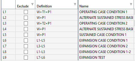

Hello,
Flexibility analysis : I have an operating case OPE1 = T1 + W + P1 and another one OPE2 = T2 + W + P1.
I get two expansion cases : EXP1 = OPE1 - SUS and EXP2 = OPE2 - SUS
I then can get a final expansion case to get the full range case between T1 and T2 : EXP3 = EXP1 - EXP2.
What is the difference between EXP3 and just doing OPE1 - OPE2 directly?
(Example above is just here to illustrate)
Thanks in advance
I think they should be the same. By default Caesar II will populate a load case similar to your last method (OPE1 - OPE2) which I've used for worst case scenarios of operating temps to shutdown temps in the winter or other large swings.
Out of curiosity I ran a quick test doing it the first way you suggest (EXP1 - EXP2) and the code stresses seem to be identical. But I don't see a reason to do it that way vs just directly from operating cases.
But it's not though. I've tried it on my current model, and i've got completly different stresses
Nevermind! It gave the same results i forgot to switch from sus to expe when doing the final case... Sorry for useless post
