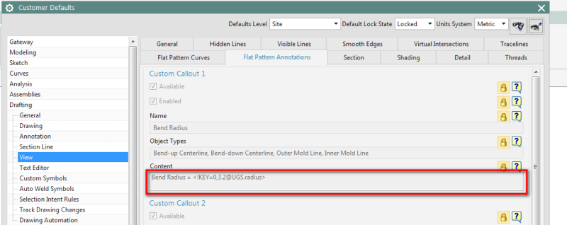

Our dimensioning is done based on ISO standards, with a comma (not a decimal pt) in the number.
I would like my flat pattern annotation to be the same way, but it shows up as a decimal pt.
How can I change the decimal pt to a comma in the note ?
I am on NX10

In the customer defaults you will find the formulas for the callout. The formula is using a point (3.2) as Decimal delimiter. Change that to a comma.
