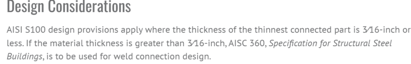

Take a look at this article, Link. As jittles said this welding would fall under a AISI code and not AISC.
I've dug into AISI's code and Yu's text on this topic. I've come to the conclusion that you can have a flare bevel groove weld with a leg/effective throat well in excess of the material thickness without a problem. Like a lot of codes, it doesn't explicitly say it....but it's implied. For example, in Sect. J2.6 of AISI S100-16, they give capacities for (and illustrate) such thicknesses that are obviously much larger than the wall thickness of the connecting part.
