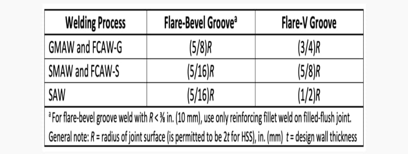

How did you come up with an effective throat of 5/16"?
In accordance with Table J2.2 (Effective Throat of Flare Groove Welds) per AISC 360-16, R = 2*t for HSS and Effective Throat = 5/16*R for Flare Bevel Groove Welds (SMAW, FCAW-S, SAW).
R = 2*t = 2*3/8" = 3/4"
Effective Throat = 5/16*(3/4") = 0.23"

Agreed, but the GMAW welding process allows a 5/16" effective weld throat to be achieved for a HSS with this radius.
5/8*0.75 = 0.47"
