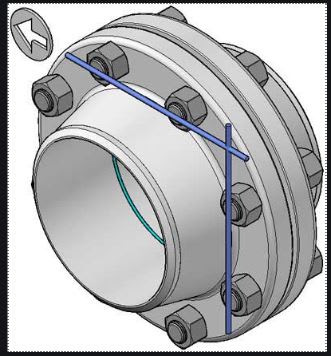

I have an 8" stainless steel pipe to be cast into a concrete wall and running parallel to another concrete wall. An ANSI 150# flange needs to be cast into the wall that the pipe is penetrating. How close to the adjacent wall can the flange be installed to allow installation and removal of the mating flanged pipe? See attached for clarifying sketch.

Mae1133,
You need to consider "Wrench Clearance", talk to an experienced Maintenance Operator.

You can do a Google search for this and find some references to go by, like what is shown below.

DGrayPPD…..Awesome! Thanks I did a search and couldn't find anything, but this is perfect.
The issue as well though from your description is the distance of the flange face from the wall in order to get the bolts in, i.e. the Top view of the sketch you originally had.
Whilst when new you can insert the bolts from the far side and hold the nut, if you ever have to remove them you can bet that the inner nut will seize and hence the bolt needs to be withdrawn in that direction towards the wall. to get the bolts in I would go for length of bolt plus 25mm as the minimum. Or are you going for a studded flange?
Oh and I know it wasn't accurate. but usually the top holes straddle the vertical centerline. Makes it much easier to get all the flanges in the same orientation.
like this
LittleInch….thanks. Yes, I regret not drawing the sketch showing the bolt holes in the wrong orientation. We always provide a detail drawing similar to the picture you provided.
