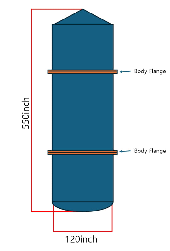

We are designing a low pressure vessel with body flanges. The internal pressure is 7.5 psiG
This would correlate to API 620 for low pressure vessels.
However, unlike API 650 there is no body flange calculation.
Thus we are using ASME Section VIII Division 1 calculation for pressure vessels,
and now the flange thickness calculated is much too thick for our design.
We are wondering if body flange thickness can be calculated according to atmospheric standards for this tank.
Any insight into this would be greatly appreciated.

For further details on the tank design,
- 550inch height, 120inch inner diameter
- 2 Flanges at 120inches from bottom and 360inches from bottom
- Cone shaped top head, dishhead bottom
- 140F operating temperature
- 7.5 psiG (Gauge pressure) operating pressure
- Contains phosphoric acid (The vessel operates P4 (white phosphorous) combustion and hydration reaction at the top of tank)
All aspects when calculated according to ASME Section VIII Division 1 is satisfactory except the 2 body flanges
Attached is a terrible drawing for reference, due to NDA and what not
ASME calculations result in flange thickness of 6.25 inches
Atmospheric tank calculation shows flange thickness of 1.5 inches
Thank you all for your kind suggestions. Any further insight based on the above information would be incredibly appreciated.

Don't get confused about the Title "FIELD" in API 620 or 650. If size is small, normally 18' diameter and small, and short, we get it shop fabricated for better quality, regardless API 620 or 650.
I have a water tank with bolted body flanges, the same as the sketch. Supplier did the flange design per whatever the water code is.
If you want to use Appendix 2, I have done large diameter flanges at 1450 F as attached. The key to reduce flange thickness is the gasket width, bolting size and quantity. More bolting and smaller diameter is better. There is a standard bolting spacing vs. bolt size, use that as reference. Gasket width not to exceed 1" is better. Wider is not better. Keep gasket and bolt hole close to ID to reduce bending moment, making hub longer, and a short thicker section (1' or 2' long)for small end will help. Must check rigidity per code. Many factors to play around and optimize.
DO NOT use gussets/ stiffeners as suggested by others. You will regret doing so. The gusset/stiffener can cause local effect due to expansion/ contraction from welding and environment that FOF may not be true flat around and you will get leaking here and there, and no way to stop it.
Standard flange B16.5 B16.47 which is quite rigid that to install gussets is fine to resist rotating force from agitator that can damage the nozzle to shell junction.
 https://files.engineering.com/getfile.aspx?folder=a5b503f8-9481-480c-8e65-cd4e5704b152&file=flange_design.pdf
API 650 has specific provisions for shop-fabricated tanks (see Annex J).
API 620 does not. I point that out, as if you take exception to the standard there, you can logically do so elsewhere as well, not to say it ought not be done.
One issue with API 620 and shop fab is that the required pressure testing assumes that the tank is anchored in the field (assuming a flat-bottom tank) so you are pressure-testing the anchorage as well. If you have a suspended bottom, this is not so much an issue.
Due to low pressure, slip-on type flange will be your best choice if no process concern. In your case you do not need to use forging material, flange from plate won't cause any issue. Your flange thickness 6.25" in my opinion is excessive, compared with my case at 1450F, 5 psig and 108" dia with 304H SS forging which has very small allowable stress. Something not right in your calc.
If slip-on is used, I will further recommend to have a short ring (1' or 2' long) as the hub with thickness twice or more of the shell to gain rigidity, that you will sleep much better.

May I ask you why you are going for flange connections in the tank shell? API 620 tank shell is welded construction. It's a tall vessel and there will be influence of external loadings on the flange joint from wind/earthquake (example: bending moment by Wind) and sidewall movement from external piping loads that will increase the risk of flange joint leak.
Remember, all flange design by any Standard (Sec VIII Div 1, Appendix 2, AWWA, ISO etc)is based only on pressure load and are not used in body flange. In your case, you need to consider other load factors.
