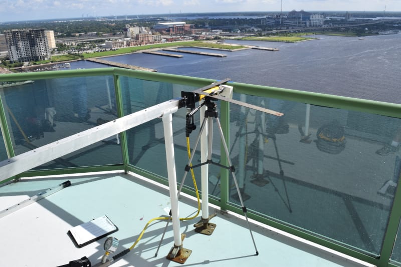

shacked...You can do that, but remember that the 200 lb lateral load is for both pushing out and pulling in. You'll only be testing one condition...your inspector or code official might require both directions.
We use a hydraulic jack with a load cell attached in line.
If no tree for an anchor, how about installing an eye bolt in the concrete or similar in pavement (might have to be deep), then run chain or cable up and over a "chair" to get a horizontal pull on the post via the portable tension scale.
You can double the 100 psf per foot lateral bearing pressure, as long as you are comfortable with 1/2" movement at grade (IBC 1806.3.4).
DaveAtkins
Ron,
Interesting load test setup. What measures do you take to "catch" the balustrading if it fails during testing? or does the load shutoff at a prescribed displacement?
Regards
Toby
Failures are usually ductile, so plenty of warning.
That would be a nice view for the day...
EireChch....Jacksonville, Florida along the St. Johns River. Taken from 38 story condominium building on the south bank of the river, looking northeast toward the stadium where the Jacksonville Jaguars (American Football) play (stadium is in background).
Agree...not a bad view! When we were doing structural testing on the windows, dolphins were playing in the river below.
