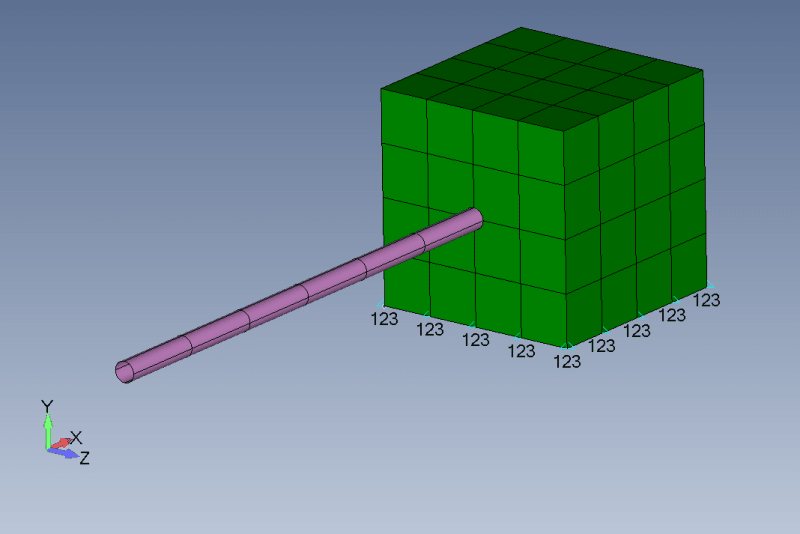

Hi Guys!!
How it's going? I hope you are ok!

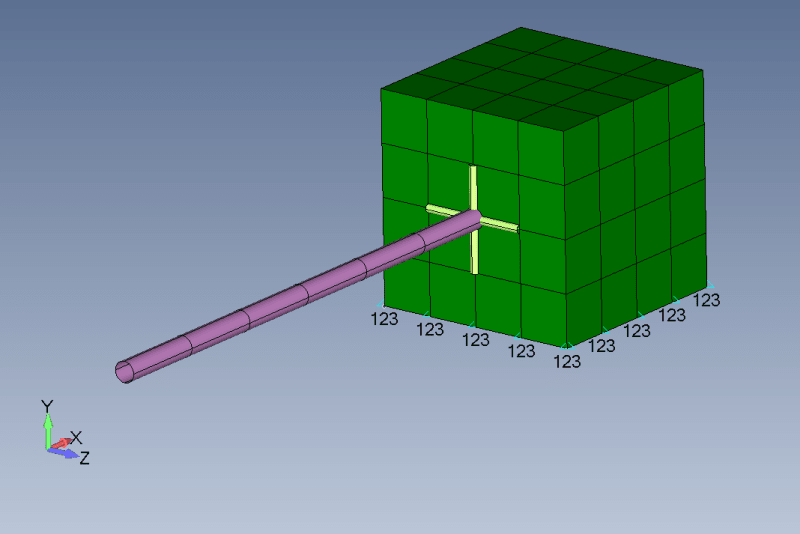

I'm facing with the flagepole connection warning and I don't how to fix it. The model consists in a box meshed with 3D elements and a wing made by two multilayer panels linked with 1D elements as you can se in the figure that I attach.
This models is a reduction of a hugh model. My idea is try to reduce the detailed model with this.
Any idea??
Thanks!!!
Msc Eng. D Cattoni
 https://files.engineering.com/getfile.aspx?folder=560705f9-3c2c-4fd7-9e90-d1794af26731&file=sate.PNG
Solid elements dont have rotational DOF`s. Your wing can rotate around X axis.
Ass some additional beams or RBE2 spiders to prevent this rotation.
