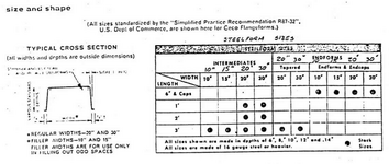

Alternately, the pan is usually 20" or 30" and the joist width is somewhat selected by the engineer designing them, 4", 5", 6" and the like (speaking extemporaneously here I'm not looking at the tables). They also made tapered end pieces if you had shear problems at the joist/beam (girder after 3 pm in Paris), or you widened the joists.
Usually there are CRSI tables involved, (or when I have to do evaluations of these, and it's been a while, I use the old CRSI tables, and they usually justify the design reasonably well, although Fling [a rather big name, so I gather, in Ohio, although now that I look, he's a past President of ACI, ] and all his cohorts and spin-offs and people who worked for Fling tended to use a lot of moment redistribution so the beams can require a little manipulation of the moments via redistribution to make them work).
To make it a "full" dimension there's sometimes a filler pan or a makeup pan or some other term, it looks like the pans were standardized at some point, and prior to that, naturally, they weren't standardized.
This is "what I have" and it looks like it's a photocopy of something that was cut and pasted into a sheet of engineering paper (hence the "National" on the left margin), and then photocopied at least once more.
