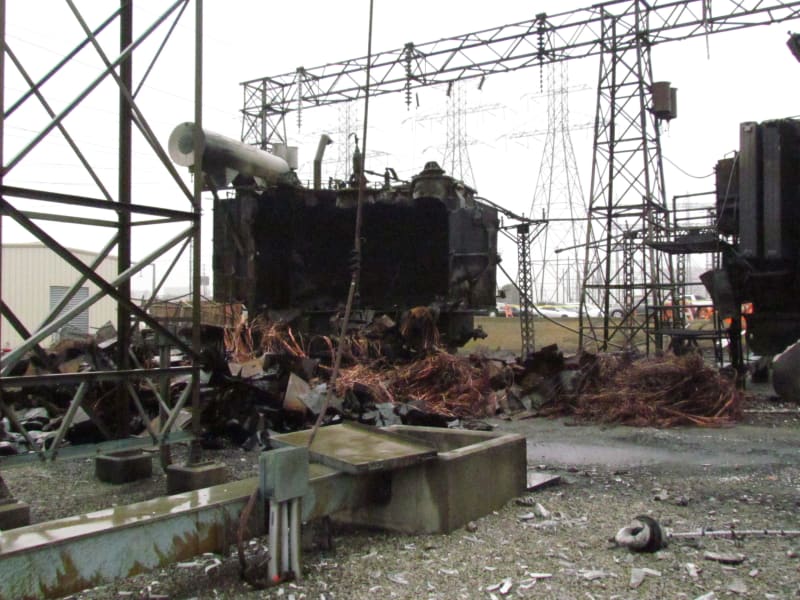

Here's a view of the mess created around a 230 kV stepdown transformer; you can clearly see how far material has been thrown.
Note that this is just the aftermath, and does not reflect that most of this material was on fire prior to this . . .
A fire wall between the transformer and the adjacent building might be highly advisable.
