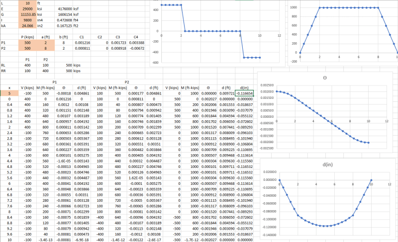

attached is a spreadsheet for the two point load case using my formula derivation above. FILE
Orange cells are user inputs
if you have an off balance load setup you can goal seek Theta in cell L20 to be 0 by changing cell A20 to get the location of maximum deflection.

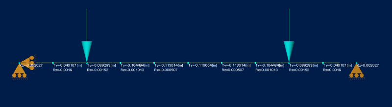

For the example calcs below beam is a W40x149, ka = tw*d = 24.066 in^2 with two 500 kip point loads at 2ft and 8ft, L = 10 ft.
Screen clip from commercial software with shear deformation included showing exact agreement:
(nodes in screenshot are in 1ft increments)
Spreadsheet results (I use a different sign convention so my theta and delta are the opposite sign):

If you need it to be metric adjust the inputs and the formulas in column D so the E thru kA values in column D match the units you want to use for length
Adjust the P1 and P2 force inputs to align with the units on E and G
Adjust the "a" value to match the length units
That gets all the inputs into consistent units
Deflection reported in column M is in the consistent length unit, adjust the multiplier in column N to get to the units you want.
