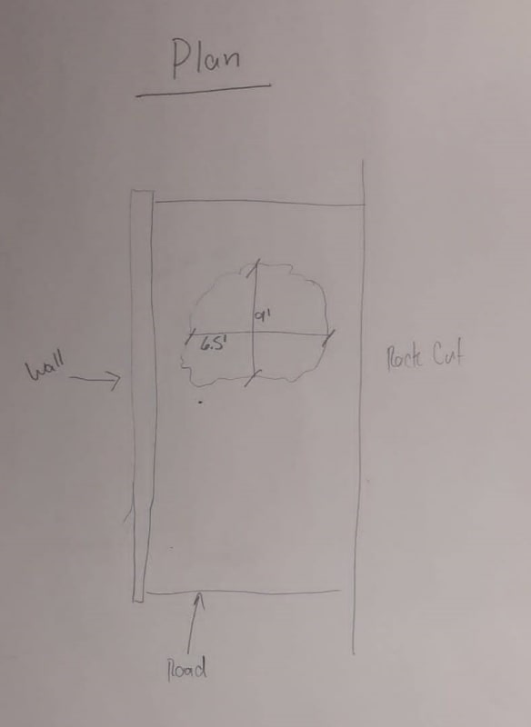

What is the lateral extent of the cavity , specifically in the X and Y directions ??? You kinda need this info if you plan to use flowable fill

I would really need a rough 3D sketch of the cavity to see what the best way to fill it is.
I was thinking filling it from the front might be easiest but it looks like the top of the cavity is higher than its face opening?

@mining man Please see the cavity dimensions below
@EireChch I was thinking the same thing with regard to the vibrating. Yes, the top of cavity is a fair bit higher than the face opening. See dimensions below.

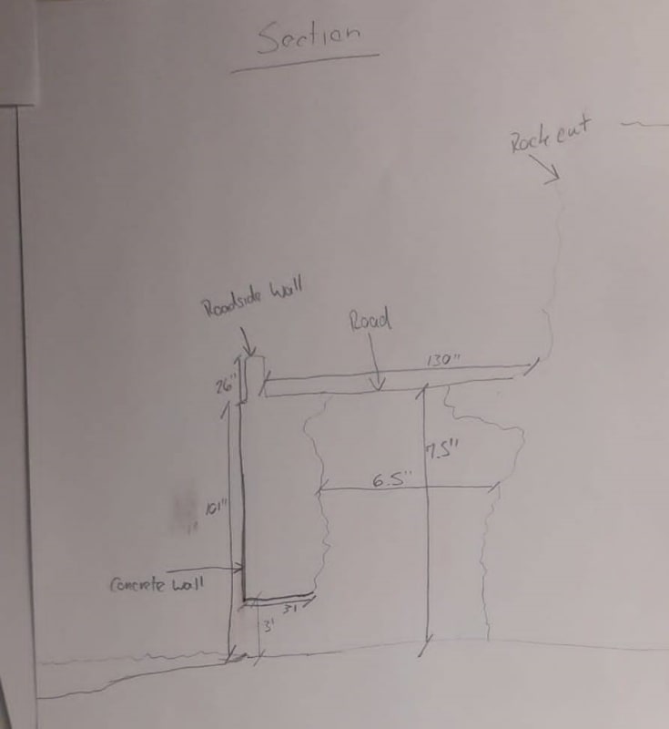

The client sent me this sketch; disregard their unit error in the cross-section. It should be 6.5' wide and 7.5' tall.
Ok so filling from the road surface is the only option.
I would not fill directly to beneath the road surface as you will create a massive hard spot. Overtime the rest of the road may settle and this will creating a raised/proud portion.
I would board up the lower face opening and backfill with lean concrete to 4ft and then do a typical road build up above. IE layers of compacted aggregate and your asphalt or what ever your road finish is ontop.
If someone was able to map that cavity with such detail means that they were likely inside it which is not good. I would set all equipment back at least 10ft from edge (7.5ft really based on a 45 deg angle form base but lets call it 10).
You could place a long platform/deck or planks to span across to opening to allow someone to supervise the filling and make sure you hit the 4ft.
After that the road build up could be constructed with a small excavator and plate compactor. The excavator to step the sides of the 3.5ft remaining face. Could be done by hand either as its so small.
Stepping the sides will allow you to stitch your road build up into the existing road build up which will help them to perform as one.
On a side not, it seems as if you should do some geophysics to check for other cavities along the road in that specific area. MASW or GPR would be ideal for this.
EDIT - Sorry just realized you are in a rock cut from the sketch and photos. My previous recommendations are somewhat not applicable now.
Filling to nearly full height of the cavity is likely ok since theres not much difference in stiffness between concrete and rock.
