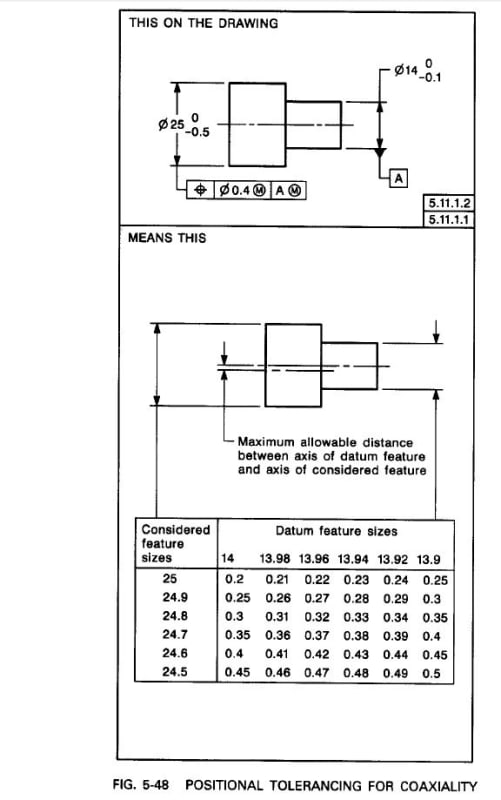

The below pic is what I think Evan was referring to in his reply. I understand these displacement questions/situations, but they simply follow the idea that datum shift is added to bonus with a single feature.
These displacements questions is what was throwing me off...if you have a single datum feature acting like the primary datum and only one feature located to said datum, you may be able to simply add the datum shift to the bonus, but anywhere otherwise all bets are off. 3D's example of the clocking secondary datum hit home for me.
That's a fairly useless diagram. But if it's on the test it's the only right way to answer. The displacement can be much larger at installation but it's not to show any practical use.

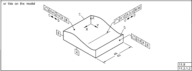

Hi All,
Figure 11-31 in Y14.5-2018 includes both orthographic views (that has the "view dependent" direction for the line elements) and a model-based view. In the model-based view, the direction of the line elements is defined by an example line element drawn directly on the toleranced surface:
I'm not sure that this fully defines the direction of the cutting planes and tolerance zones. It's implied that the cutting planes are normal to datum A, but they could also be parallel to datum A. I'm not sure if the direction has something to do with which way the line profile FCF is facing - hopefully not.
