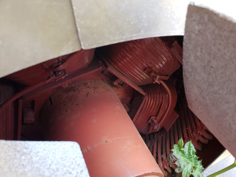

The generator is a CAT C27 635 kW 600 Volt 60 Hz (I found a picture of the nameplate). The station supplies power to a small off grid remote community, air access only summer, ice roads winter (IRT have been there). There are also two 3516 at this site. We run these generators via PLC control to best fit the load. We use Woodard DSLC2 for load control, sync, load share, etc. and the Basler DESC250 (AVR)voltage regulation and var sharing. BestComm software is used to set up the AVR and to view the metering of the AVR. I'm trying to avoid having to remove the rotor until I'm sure that has to be done. What test could be performed with the rotor still in place.
I tried to attach a few pics. Thanks JC

I cut some info out of an old training handout for a 4 pole rotor pole drop test, attached in a word doc.
Before you test, LOTO the engine, make sure it will not crank or start.
You may be able to see one or two jumpers from the rear, depends on vintage of the rotor, older rotors had two of the jumpers in the rear and one in front, either way you can get an indication if there is a problem.
If you want to verify validity of the testing, rotate the engine about 45 degrees and repeat the testing, results should be close to the same if the test was properly done. This test won't test each pole individually, but if the results are uneven, you have a problem with the rotor and you know it is one of two poles you tested.
This will diagnose a constant problem, if the problem is intermittent then when stopped the unit may test ok. Because of the info you provided so far this may be an intermittent issue. Several years ago we had a run of rotors with winding problems, run initially for some time, started failing diodes, hard to pin down, most of our diagnosis was done using vibration analysis and a DECS200 so we could do datalogging. Gens would run anywhere from 2-20 hours then trip, paralleled units would trip on loss of field, single units on under-volts. All of the units that suffered damage to the generator were paralleled units, we found in several instances the loss of field settings didn't properly protect.

I'm arranging a trip to site to perform some tests, that include the pole drop test with 45 rotation. hopefully I can get on the pole jumpers. I've attached a picture showing the jumpers on a 3512 rotor (6 pole). I'm thinking the C27 has similar jumpers where measurements can be taken. The PMG produces 90 volts at 240 hz @ 120 and 240.
