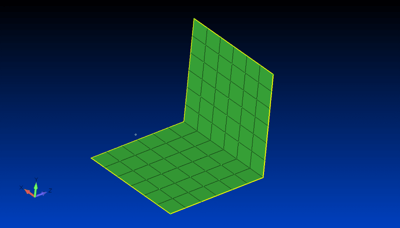

Start with a simple model, two surfaces to make an angle.

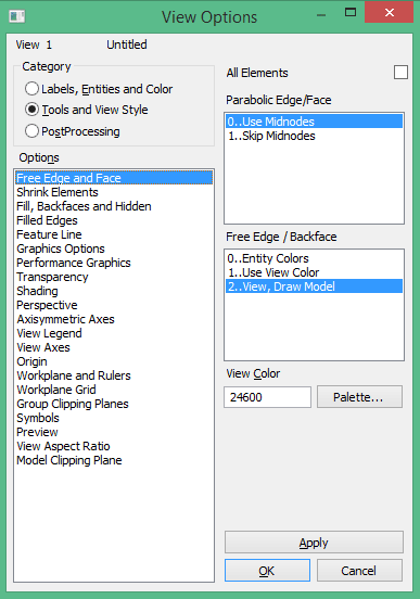

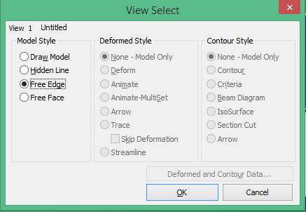

Coincident nodes can be checked using Free Edge display.
First press F6 and set Tools and view style->Free edge and face->Free edge->2..View, draw model.
Then press F5 and select Model Style->Free edge.
Now free edges, where elements not connected with other elements, are highlighted as yellow lines.
Here is two plates before node merging.
And after.

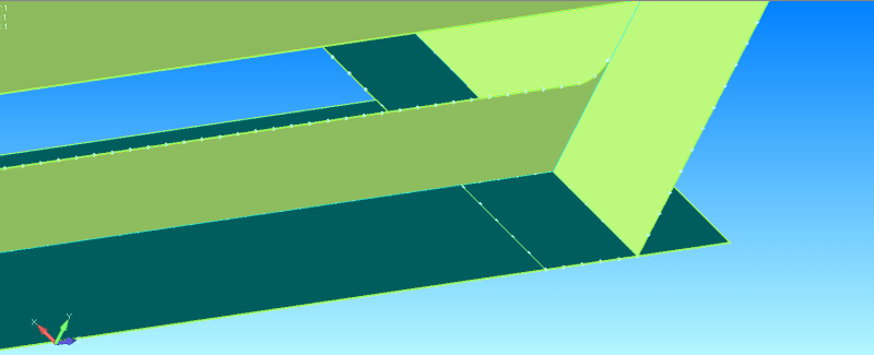

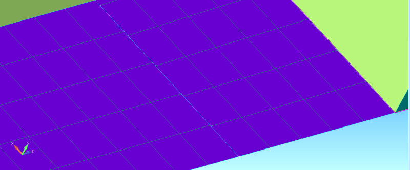

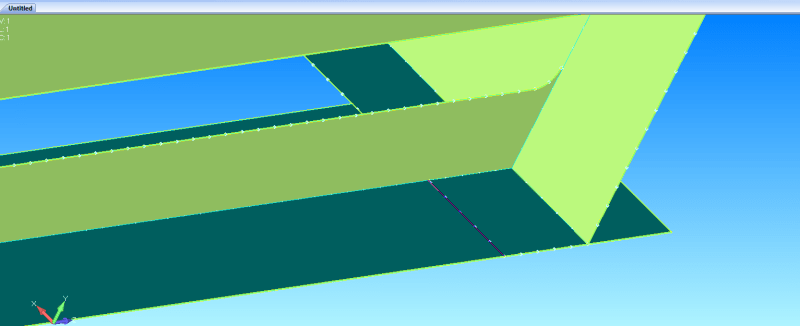

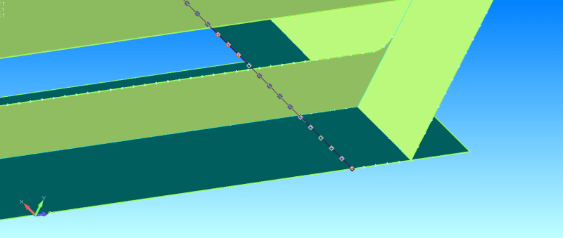

Ok, so I definitely have a free edge where two surfaces should be joining and I think it is due to a coincident curve that I can't get rid of. The curve is NonDeletable, because it is associated with the edge of the surface. I have merged all nodes to a tolerance of 0.016 with my mesh size in most places being 0.5. I have deleted all deletable curves in the model and deleted and re-modeled the surface in hopes of the surfaces joining eachother if drawn in a different way. I'm still getting a free surface where I should not be. What can I try?
you can manually select the nearby coincident nodes and force their merging.
You can run the coincident node check with "detail list" (instead of "merge") and see how close things are. How do you know 0.016" is grabbing nodes that you want to merge ?
Using element "shrink" is a good way to see these difference.
You can remesh the two surfaces (at the same time) ... maybe this won't work since the surfaces don't share a common curve.
You can mesh all the coincident curves ... but maybe this won't work (if curves are different lengths).
As a last resort, you can move one node to another node's position (modify/edit/node, select node to move, use "on node" as the new location).
aren't free edges a function of geometry and not nodes though? If I have a free edge I thought it suggested my surface geometry is not connected and something needs to be changed there.

I'd've thought "free edges" detected that adjoining elements were not joined (ie two sets of nodes along the common boundary.
