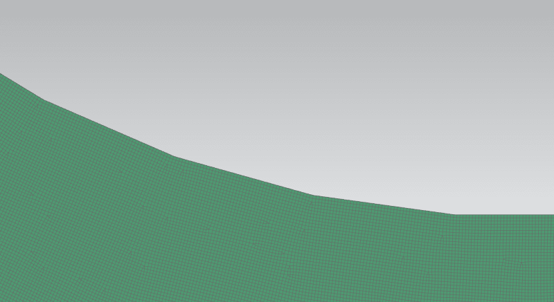

Im trying to mesh and simulate stress in a simple 2d example.
This represents a 1x20x100mm flat piece of steel under stress.
There is a stress concentration (notch) in the middle, with diameter 2mm.
I have been reducing the element size gradually to find a convergence value for maximal stress at the notch. But when I get down to element size 0.003mm, this happens:
Now, clearly the curve of the notch (radius 1mm) has not been interpreted as a curve, but as a many-sided polygon. The elements are smaller than the sides of this polygon, so the error is in the curve itself, or in the mesh interpretation of the curve.
So, how do I get the curve to act as an actual curve, or at least up the rezolution?

Welcome to the world of FEA. The meshing step breaks your model into small elements, all of which have straight sides; this is the nature of finite element analysis. It is the job of the analyst to pick a mesh size and type, refine it (globally or locally as needed), and interpret the results. Since you know that your real model doesn't have those small discontinuities, ~38MPa is a good estimate of the stress in that area.

Yes, this is true. But as I mentioned, the percieved "sides" on the curve are much bigger than the element size.
Sides of curve: roughly 0.1mm <-- why so large?
Element size: 0.003mm
Thus, there should be more sides to the circle (i.e. "higher resolution").

If you want to control the mesher to be exact size, you will need to use Mesh Control command, and define the edge of the notch to have specific number of nodes or size. Without using Mesh Control, the 2D mesher is only using 'element size' as an approximation for the overall surface to mesh, and would produce results which might not aligned with your intention.

Tuw, Thank you very much for the feedback. Unfortunately, it seems I cannot apply your advice in this situation. Let me explain.
The diameter of the notch is 2mm. The circumference of a whole circle is c = d*pi = 2(pi)mm. The arc in the notch is half of this =(pi)mm. That means I wil have (pi/0.003) elements along the arc. So, roughly 1047 elements along the arc.
I have now tried to add a Mesh Control modifier to the arc, density type: number on edge. Number: 1047.
And I still get this:
And yes, the model is properly constrained in the appropriate DOFs. It is experiencing a tensile load horizontally (top picture).
You'll never get it exact due to the polygon geometry abstraction used.
What do you have in preferences / meshing ?
High Resolution Polygon Bodies turned on ?
Project Node to CAD geometry turned on with a decent project tolerance ?

I took a look at the Prefs/meshing dialog, and enabled the Project Node to CAD, but this did nothing.
Since I am using NX12, the High Resolution Polygon Bodies option has been moved to the polygon geometry tree. I assume it has previously been located in the preferences?
Anyway, enabling the high resolution in the aforementioned area made a huge difference! That was the key, truly. I still do not have full control of the resolution, but this makes my life a lot easier. Thank you!
