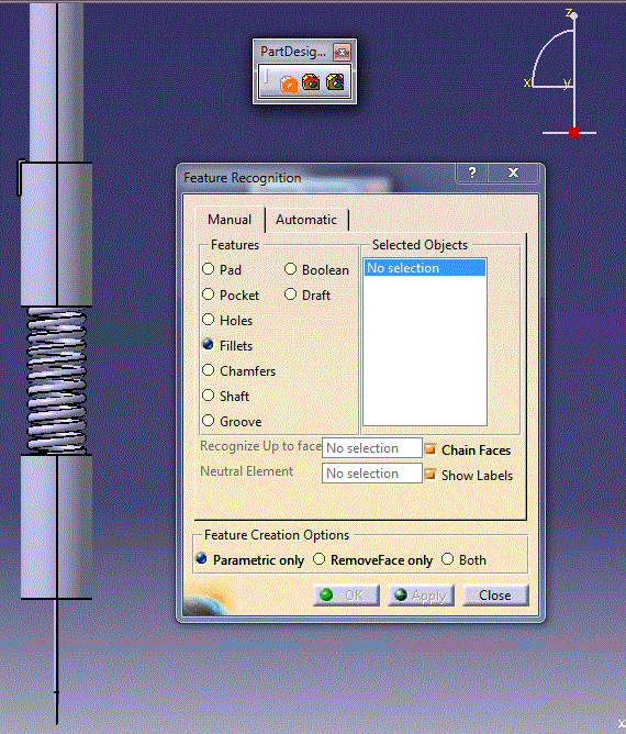

Catia V5 has this tool (feature Recognition)

The tool mentioned by jerry1423, while it has some of the characteristics of 'feature recognition', as mentioned in the linked item, these are generally aimed at making it easier to define manufacturing operations such as drilling holes or chamfering the edges of a model. It uses some of the same underlying technology as is used in 'Synchronous Modeling'.

I did some more research and it looks like I was mistaking cam feature recognition for cad features. A one button solution to find cad features would be nice but realistically I do not have a need to make changes to entire non-parametric models.
