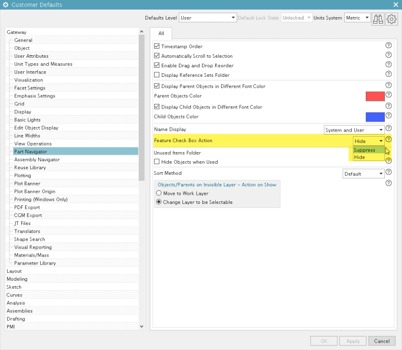

In 1847 the part navigator has the default action for the feature check box's set to HIDE instead of SUPPRESS, like I'd like. I have found out how to switch this in the Part Navigator Properties, but it doesn't save this globally, forcing me to have to do this every time I use NX. Can someone tell me how to make this a permanent change?
Thank you
It's in the customer defaults.

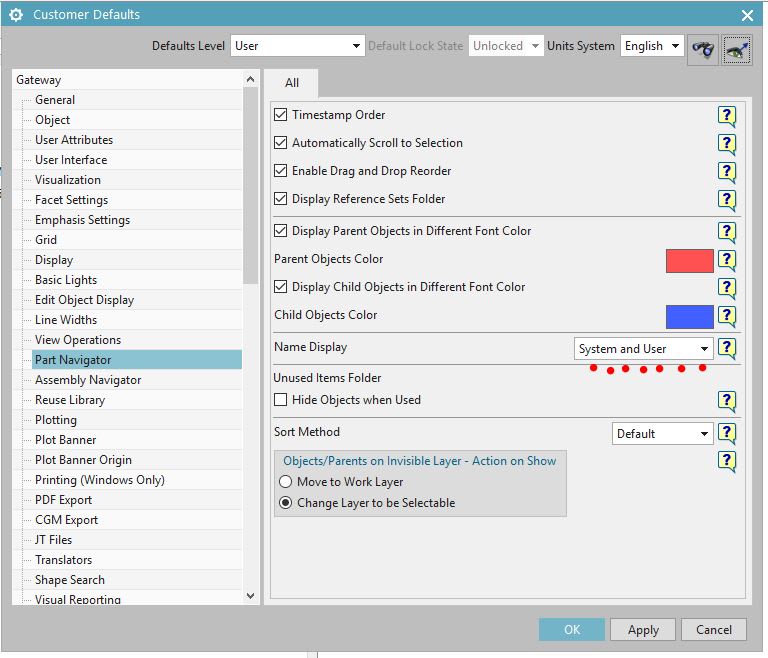

Mine doesn't have that setting, any idea why? Strange..
Maybe this setting is in NX1872 or after but not in NX1847.
I don't have NX1847 anymore and maybe Anthony also.
Try searching it in another place.
