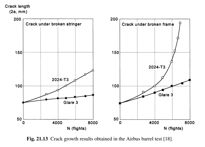

Test results show composite fiber-metal laminates (Glare) may be stronger in fatigue than monolithic 2024-T3 .
