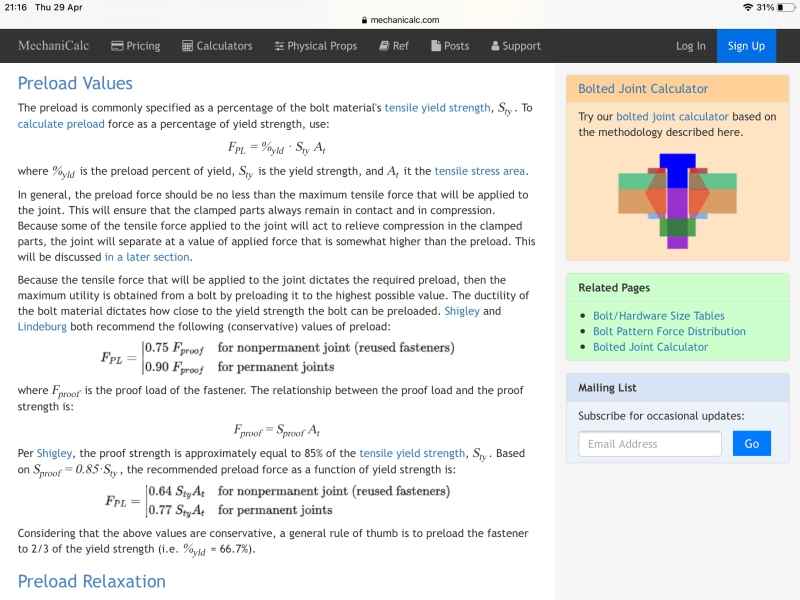

I am doing pretty standard bolt calculations and noticed a difference between the power screw and regular fastener calcs. The fastener situation I have is bolts holding a pressurized pipe flange together (ie. external load is in the same direction as the preload (or rather opposite direction but same axis))
The textbook im using is shigley and a lot of sources on the net but I cannot find a solution to the questions below (please see attached pic for ref):
1) For power screws Von Mises is used to combine axial stress, thread bending and thread shear due to rotation. I know that the thread shear stress due to rotation is zero but why isnt Von Mises used to combine the axial and thread bending for normal fasteners?
2) Why isnt thread shear due to applied force taken into account?
All examples equate the preload force to 75% or 90% of the proof strength (or rather the force that produces the proof strength in the minimum area of the fastener). adding the external force will slightly increase the tensile stress in the bolt but not enough to exceed the proof strength. Now if you combine the tensile stress and the bending stress using Von Mises then the stress in the fastener exceeds the proof strength which means the bolt will yield (fail). when doing power screw calcs this bending stress is taken into account but not when doing normal fastener calcs.
If the reason is the shape of the thread, which approach do I use if using ACME thread for a regular fastener?
Kind regards

Im more interested about the method not the values (the UF show that the axial stress is 0.58 of the allowable yield but the UF of VM is 0.974, but in shigley they equate the axial stress to the allowable yield for fasteners, and if I do that then the VM calc is way over yield. For power screws they equate VM to the allowable yield, [highlight #FCE94F]why?[/highlight])
If it will help you here are the values you are looking for.
-The bolt size is 12pt. cap screw: 3/4"-10UNCx2.5" LG
-the preload is 11191.047 lbf
-the C value is 0.107

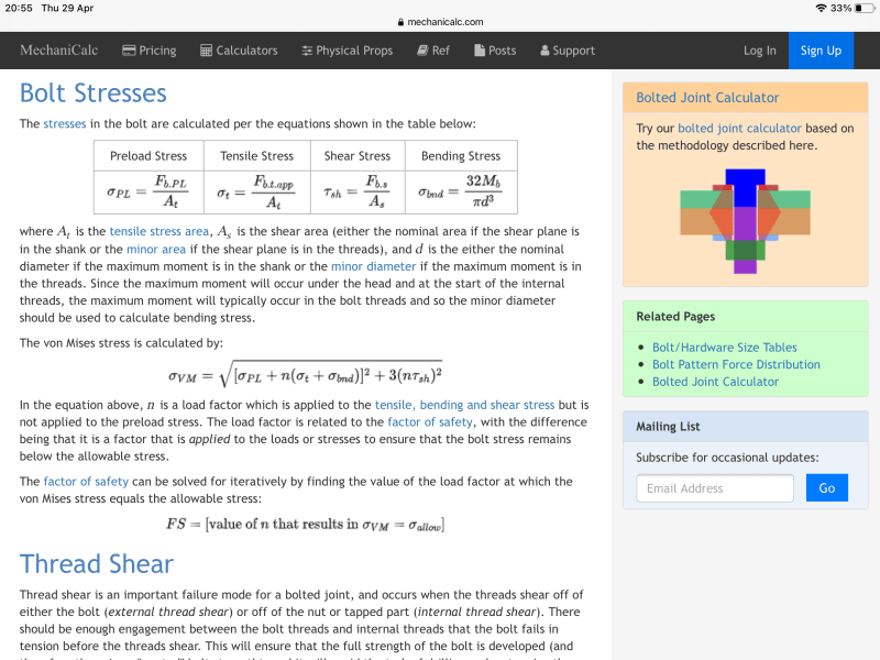

Hi Michael
Under the heading of bolt stresses it states about using the minor of the bolt when the maximum bending moment occurs in the threads see highlight, this is the same bending stress they use in power screws.
I will answer your other points later
Bolt Stresses
The stresses in the bolt are calculated per the equations shown in the table below:
Preload Stress Tensile Stress Shear Stress Bending Stress
where At is the tensile stress area, As is the shear area (either the nominal area if the shear plane is in the shank or the minor area if the shear plane is in the threads), [highlight #EDD400]and d is the either the nominal diameter if the maximum moment is in the shank or the minor diameter if the maximum moment is in the threads. Since the maximum moment will occur under the head and at the start of the internal threads, the maximum moment will typically occur in the bolt threads and so the minor diameter should be used to calculate bending stress.[/highlight]

@desertfox - please give me the formula and the variables you would use to work out the bending stress because I still think there is confusion with the bending stresses we are talking about, I am not talking about the bolt itself bending, Im talking about the thread of the bolt bending and the thread of the bolt shearing. The site you posted is talking about the shear being across the diameter of the bolt and the bending moment if the bolt is offset not because of the loading on the thread of the
I dont see how the helicopter example applies to my problem, could you please explain?
Hi Michael
The thread bending is what’s it is talking about I will try to post something later but can you please explain what this device is, all we are talking about is a bolt thread, it will help me to help you, also the calculation example you posted, that ignores shear of the threads,is this your calculation or someone else’s?
I calculated the external load in the example you sent but again is that example related to the 3/4” bolt size you mentioned. So I really need all the information you have to help you further and also the grade of bolt material.
desertfox, he's taking a microscopic look at bending of the screw thread, not the larger behavior of the entire fastener. In particular at the root of the thread analyzed as a stub beam.
If they are talking about thread bending why do they say "A bending moment could exist in the bolt if there is a gap between the plates (i.e. due to a gasket) or if there are long spacers used in the joint:"?

"If they are talking about thread bending why do they say "A bending moment could exist in the bolt if there is a gap between the plates (i.e. due to a gasket) or if there are long spacers used in the joint:"?" ... the short answer, they aren't. the moment they are talking about "A bending moment could exist in the bolt if there is a gap between the plates (i.e. due to a gasket) or if there are long spacers used in the joint" is bending of the bolt shank and not bending of a thread (as a cantilever).
Hi rb1957
Yes okay you’re right I was looking at the bending formulae for power screw threads and thought it was the same formula that they were using in the snap shots I posted above.
