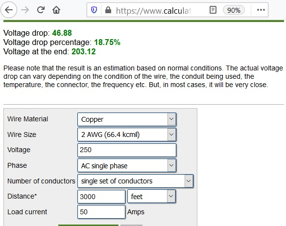

I found a statement that there are three
circuits (which makes sense from a 3 phase
generator.)
35 kw divided by 0.23 kv is 152 total amps?
That might mean each of the three 230 volt
circuits carry roughly 50 amps, with the
current dropping off a bit at each user.
I would suspect that the generators are run
at the maximum safe voltage for the appliances,
say, maybe 250 volts?
I'm not sure what the minimum voltage might
be for the appliances used there. I'd suspect
the fridges and freezers might be sensitive
to low voltage.
How about 200 volts?
With those numbers, is anyone current enough
to estimate the distance to the point where
250 volts at the source drops to 200, over
fairly widely spaced #2 copper, carrying 50
amps?
Eleanor White
ANSWERING MY OWN QUESTION re estimated voltage drop:
I thought I'd try an on-line voltage drop calculator
to estimate the voltage drop around the average load
on Pitcairn Island. The image below is a quick
result:
That quick estimate suggests that under the worst
possible condition, i.e. a full 50 amps at the very
end of each of 3 feeders, it would take 3,000 feet
of #2 copper to drop 250 volts to 200 volts.
One factor the calculator page didn't take into
account is the wide spacing of the conductors,
which would mean the result is a little optimistic,
but still, three feeders branching out even 2,000
feet from the generator would cover most of the
closely spaced village.
Eleanor White

Eleanor; I think you've pretty much nailed it. With the ÷3 and the 2AWG (some I see might be larger than 2AWG). That would work great. At each end user they'd convert to 14AWG or something like that.
Keith Cress
kcress -
I have seen some voltage charts that led me to suspect that the wire service provider was keeping the voltage as high as possible to drive up consumption.
Even higher than the supposedly regulated maximum allowable voltage.
Most customers are not as aware of overvoltage as you may think.
