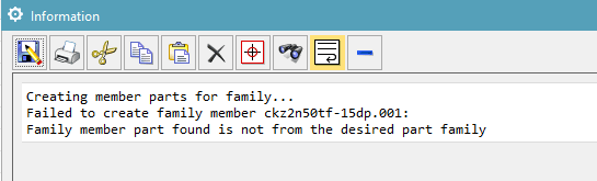

How does that work, can I ask? On the spread sheet, do I just give it the same OS Name as the component we are calling? I was expecting that would cause it to try and make a family part with the same name as one that already exists and cause an error.
Doesnt matter. I will try it and see how it goes. lol
Yeah this is what I thought would happen.
I don't think you are understanding exactly what I am trying to do. Or I am not understanding how I am to do it. lol
I don't want to create new family members with the components inside of them. I just want it to retrieve the family members that are already created. Not as part of an assembly. The original family master has about 60 members it created. I want to put a file in an assembly that gives you a choice out of only 20 of them.
I would just split that one family master into three different family masters. One with the 50 series, one with the 60 series and one with the 80 series. The problem with that is in order to create the members with the same names, you need to delete the originals first. Which then leads to a problem with all of the tools that were using the originals will no longer load the component up. Even though you create a replacement with the exact same file name in its place, the tools somehow still recognize it as being different. So every tool then needs to be changed manually.
